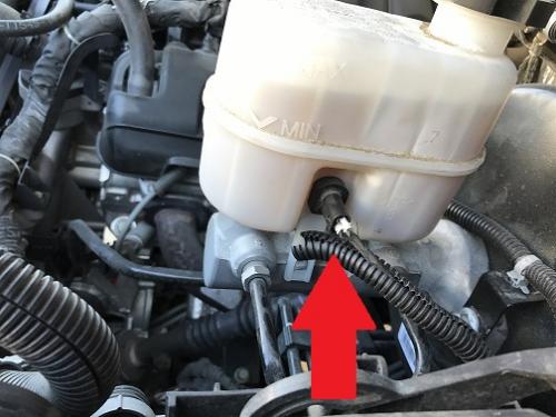

I recently went for an oil change at the same dealership, as I purchased one of the extended oil change plans (it was dumb of me to do). In casual conversation with another service advisor, he mentioned a brake fluid sensor code that came on. I'd never heard of this, simply because I've never messed with a master cylinder before (never had a need). This sparked my curiosity on what exactly this sensor was. Popped the hood, and boom, there it was. What I thought was going to be my nemesis, the sensor. I went to touch it, and the wires just fell out.
The way it is supposed to look:
How did this sensor wire clip break? When I took it to the same dealership that I purchased the oil package from. and they replaced the brake booster.
