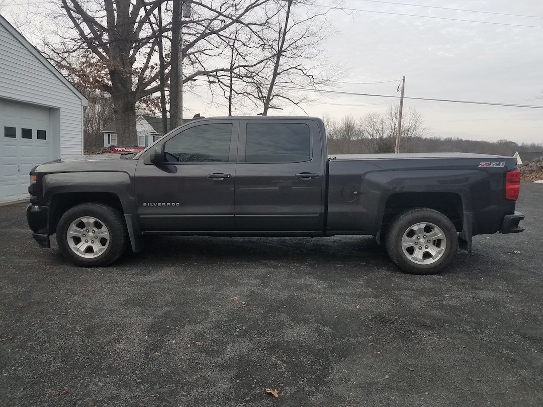

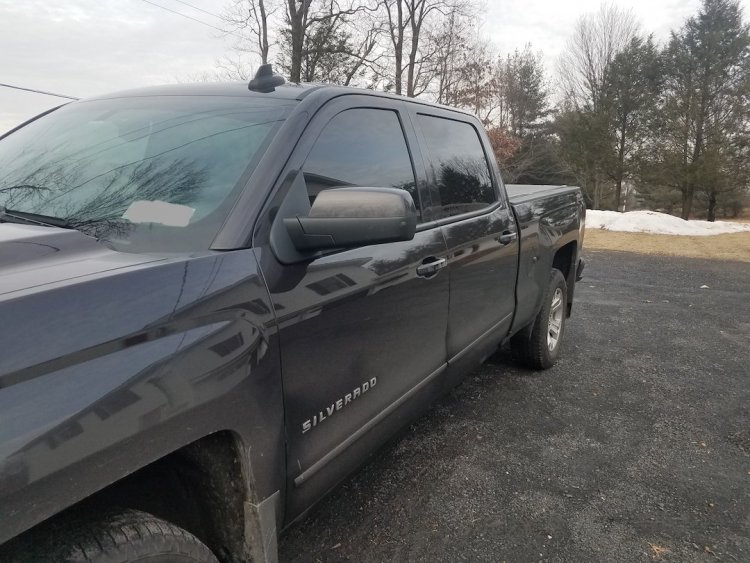

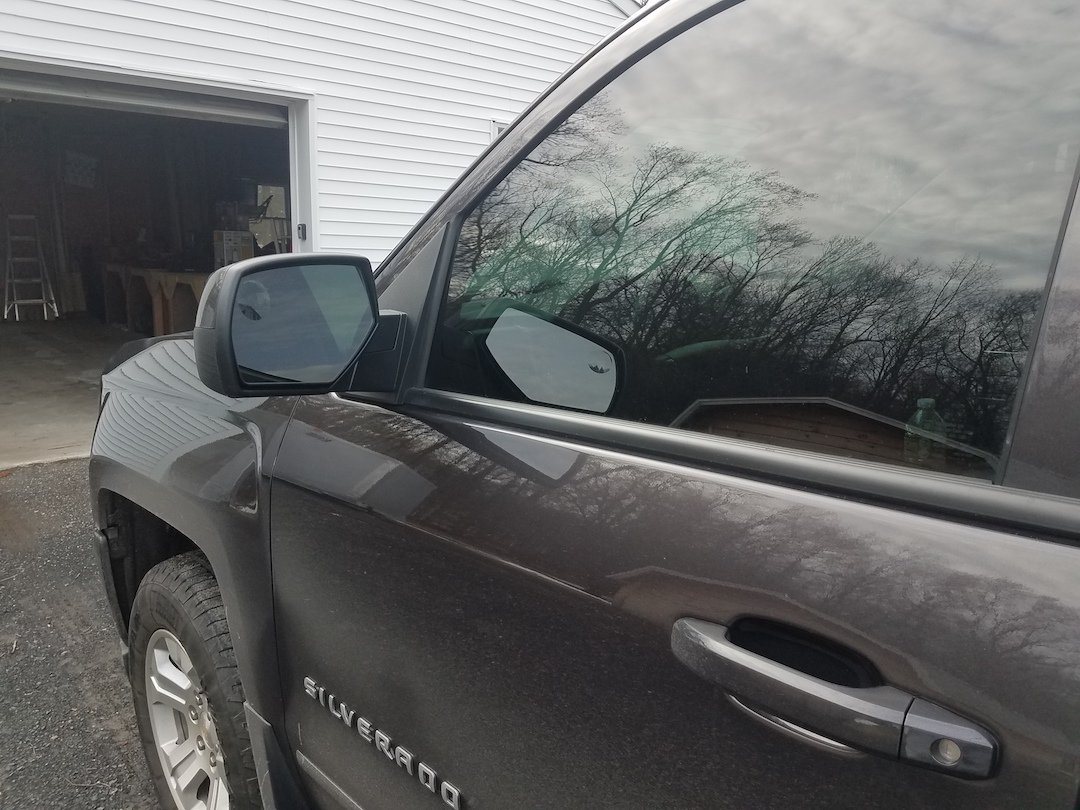

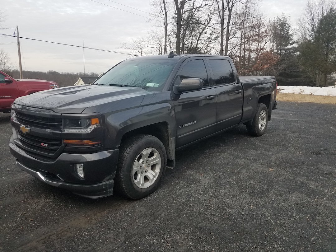

I have a 2016 Silverado LT Z71, Crew Cab, 6.5ft bed.  I constantly tow an enclosed trailer for construction that is a bit wider than the stock mirrors.  I am looking to upgrade to towing mirrors.  After reading through over half of the pages of this forum topic, I'm confident that I can finally get some towing mirrors squared away on my truck.

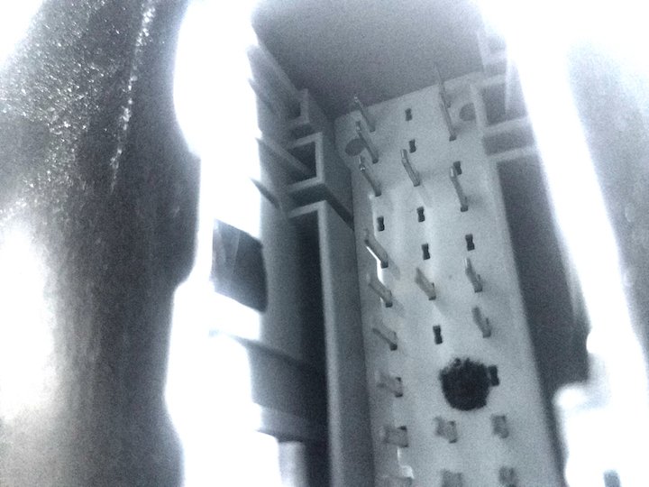

My current mirrors are power adjust.  No heat, no turn signals.  I checked the harness in the driver's side doorframe, and the required pins are present from the truck's interior for adding heat, running lights, and turn signals.  Phil, I'm definitely interested in your custom harness for the A1 Auto tow mirrors.  I've been trying to figure out the difference between the 1AMRP01792 and the  1771.  The price is different and the 1792 comes with chrome caps.  Beyond that, I can't find any differences.  Advice?
I would like to replace the stock mirror control to integrate the power fold.  Is switch 23154702 the part number that I will need?
For some questions that I haven't seen as of yet:  Is there a way to wire the rear facing white spotlights so that they (along with the reverse and cargo lights) illuminate when the key fob unlock button is pushed, and/or when the truck is shifted into reverse, all in addition to activating the cargo lamp switch?  Can the forward facing amber running lights on the mirror be wired so that they can be activated to be brighter as a turn signal?

My current mirrors are power adjust.  No heat, no turn signals.  I checked the harness in the driver's side doorframe, and the required pins are present from the truck's interior for adding heat, running lights, and turn signals.  Phil, I'm definitely interested in your custom harness for the A1 Auto tow mirrors.  I've been trying to figure out the difference between the 1AMRP01792 and the  1771.  The price is different and the 1792 comes with chrome caps.  Beyond that, I can't find any differences.  Advice?  Your mirrors should be DL8.  Check your glove box for this RPO Code.  They should have heat.  The heat on the mirrors are activated by the rear window defogger.  So if you have this button on your HVAC controls, your mirrors should be heated.  Thanks for supplying the photos on the door jamb.  This makes it really easy to confirm things.  Since you are a 2016, you should be fine upgrading to virtually any mirror, including gaining power fold.  The difference between the mirrors you specified are the caps.  if you order 01792, you WILL get 01771, but it'll come with a separate box of the appropriate caps.  Here are some additional links to the SAME mirror offered by AM Auto for slightly less.  Same mirror.  10-year warranty with AM-Auto as opposed to Lifetime Warranty with 1A Auto.
