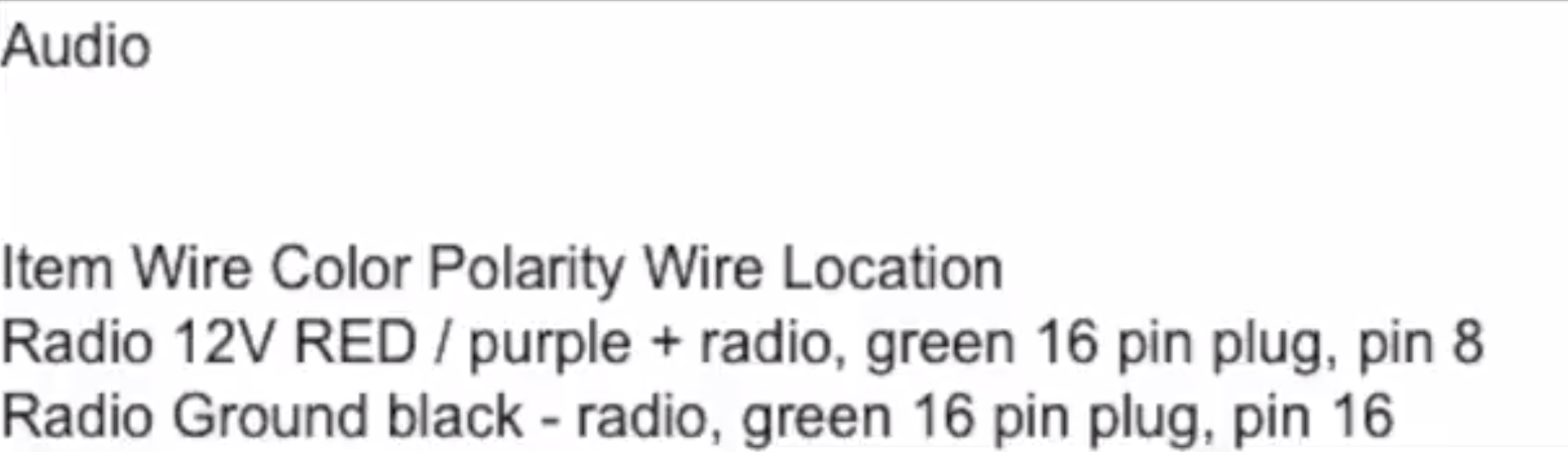

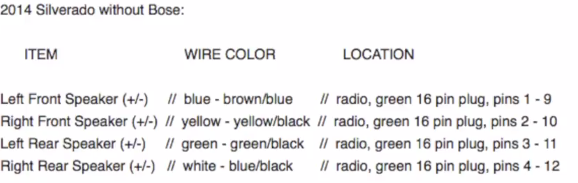

How did everyone wire them up? Where are you hooking up the RCA wires?
You can tap into the speaker outputs via the green plug at the headunit to feed a Line Output Converter to get RCA outputs to the new sub amp. If your sub amp has hi level inputs just tap into the speaker outputs. Some folks worry about amplifying the door chimes which come from the front speaker output, so they tap into the rears. If you use the high level inputs on your sub amp then you avoid having to tap into a remote turn on power source.
Your sub amp + power source should come directly from the battery. I grounded the amp to the chassis via a front console mounting bolt.
ok makes sense. Ive installed many amps in the past but always hooked them up to aftermarket headunits
