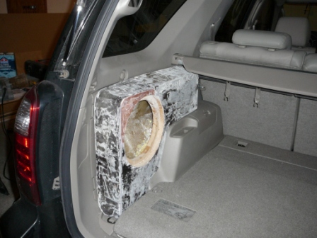

For Knotsure, you could do it with water, sand, or small packing peanuts. That sounds absurd I know, but it is the easiest way to figure out an irregular volume. I know your top plate is MDF though, which is not compatible with water. I built a box very similar to this years ago for my Ridgeline and wifes 4runner. I poured fiberglass resin inside and let it seep into all the edges and cover the mdf entirely. It was sealed tighter than any box I had ever made at that point. Also impervious to water.
