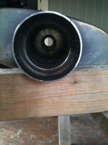

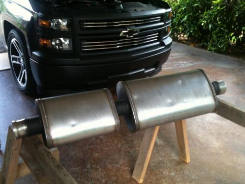

I'm running two knock off Magnaflows 14" and a 22" welded back to back and with non-catted headers and a blower it's still loud as HELL!

07 do those knockoffs have any packing inside to dampen sound? Magnaflows do so they will be quieter but probably not to the extent RaptorEater is looking for. Shoot even a Borla Touring is loud as heck in a 5.3 with LT headers and no cats.
