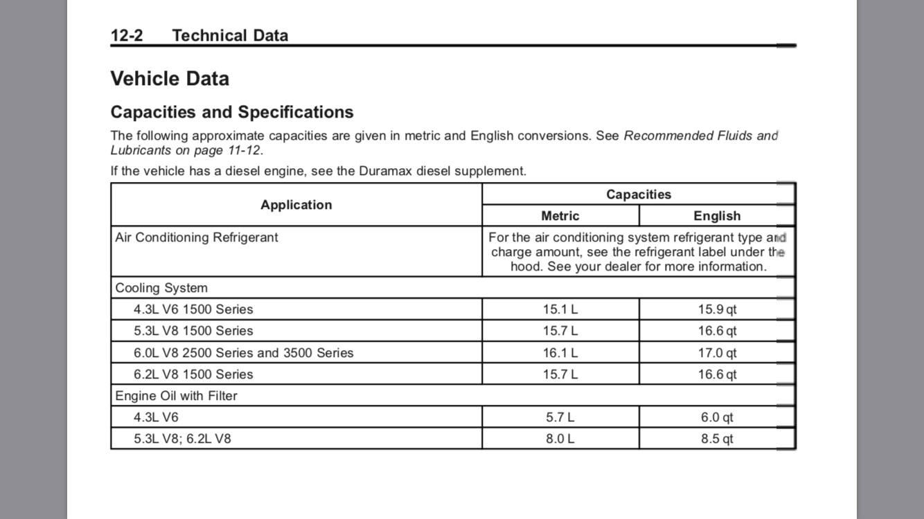

Black02Silverado Posted September 29, 2018 Posted September 29, 2018 This is off the AMSOIL vehicle look-up page. CAPACITIES: Engine, with filter..........8 quarts [1] Cooling System, Initial Fill..........16.6 quartsPassenger Car & Light Truck Antifreeze & CoolantAMSOIL Antifreeze and Engine Coolant Automatic Transmission, 6L80 Initial Fill..........6 quarts Automatic Transmission, Total Fill 6 speed LD 6L80..........12.2 quarts 6 speed W/ HD Cool 6L80..........12.4 quarts Differential, 8.25 RingGear Front..........3 pints Differential, 8.6 RingGear Rear..........4.2 pints Differential, 9.5 RingGear Rear..........5.5 pints Transfer Case, MP 3023/3024..........3.2 pints Transfer Case, MP 1222, 25,26..........3.2 pints [1] After refill check oil level. TORQUES: Oil Drain Plug.....18 ft/lbs Transfer Case Fill Plug 13 ft/lbs Drain Plug 13 ft/lbs 1

300 Blackout Posted September 30, 2018 Posted September 30, 2018 4.3L V6 - 15.9 quarts 5.3L V8 - 16.6 quarts 6.2L V8 - 16.6 quarts

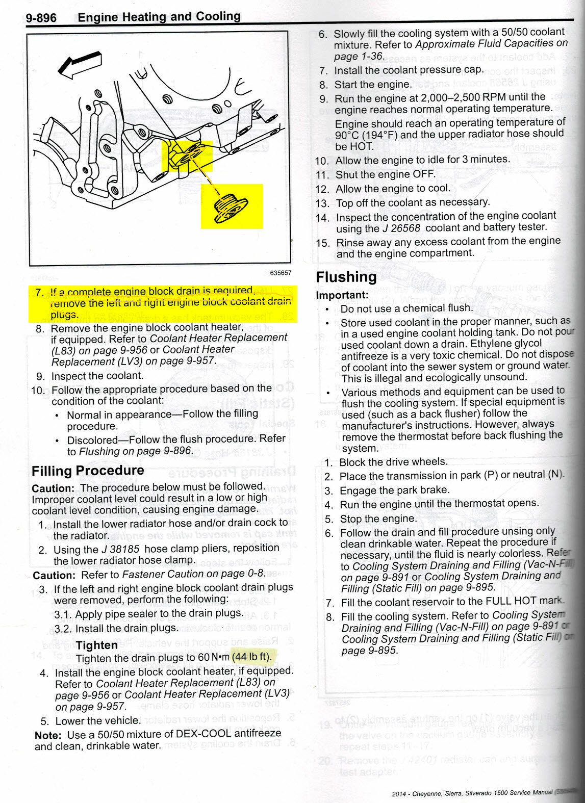

Franklin Garrison Posted January 12, 2020 Posted January 12, 2020 To get a more complete change since the capacity is over 4 gallons, one needs to remove the plugs from the engine block, which is what I would like to do, except I can find them. Are they behind the AC compressor and the vacuum pump?
