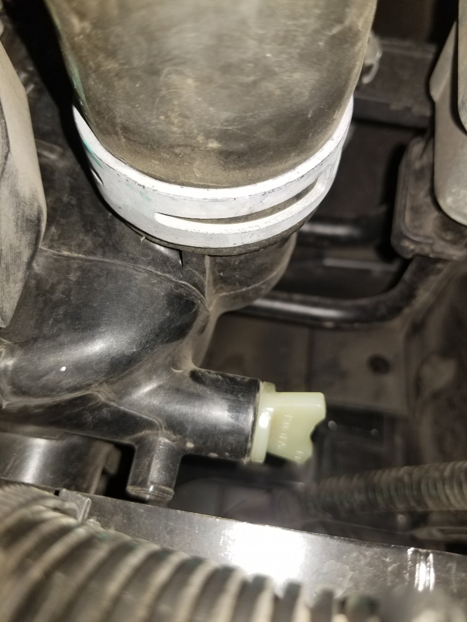

Just got a picture of it to add here for future thread searchers like me.
It's right next to the passenger side lower hose.
Cheers.
Cheers.
Thanks for posting, I've spent the last 6 years searching for that drain plug. Looks difficult to access though. My method for servicing the cooling system is to drain the overflow tank once a year and refill with 2/3 gallon 50/50 Dexcool...........good enough for me.
I never thought about servicing the coolant that way. Interesting. I never used the drain plug in any of my cars. I always pulled the bottom hose to drain. I was always afraid of breaking the plug or the plug not sealing back and then I would be screwed.
Yup, happens all the time on older cars/trucks in my neck of the woods.  If the vehicle is new I wouldn't hesitate using the petcock.  Last one I did on a old Toyota...off to the store to find something to fit a 15yr old car....head gaskets were gone 40k prior she was a mixing oil and starting hit my purse.
I still hesitate on a newer car. It’s all cheap plastic crap with a throw away radiator. Did my other car that’s 6 years old and didn’t touch it. Sometimes things are best to be left alone.
Cheers.
Is this a normally threaded left turn loosen petcock?  I think I've had some engine block petcocks that were reverse right turn open.
