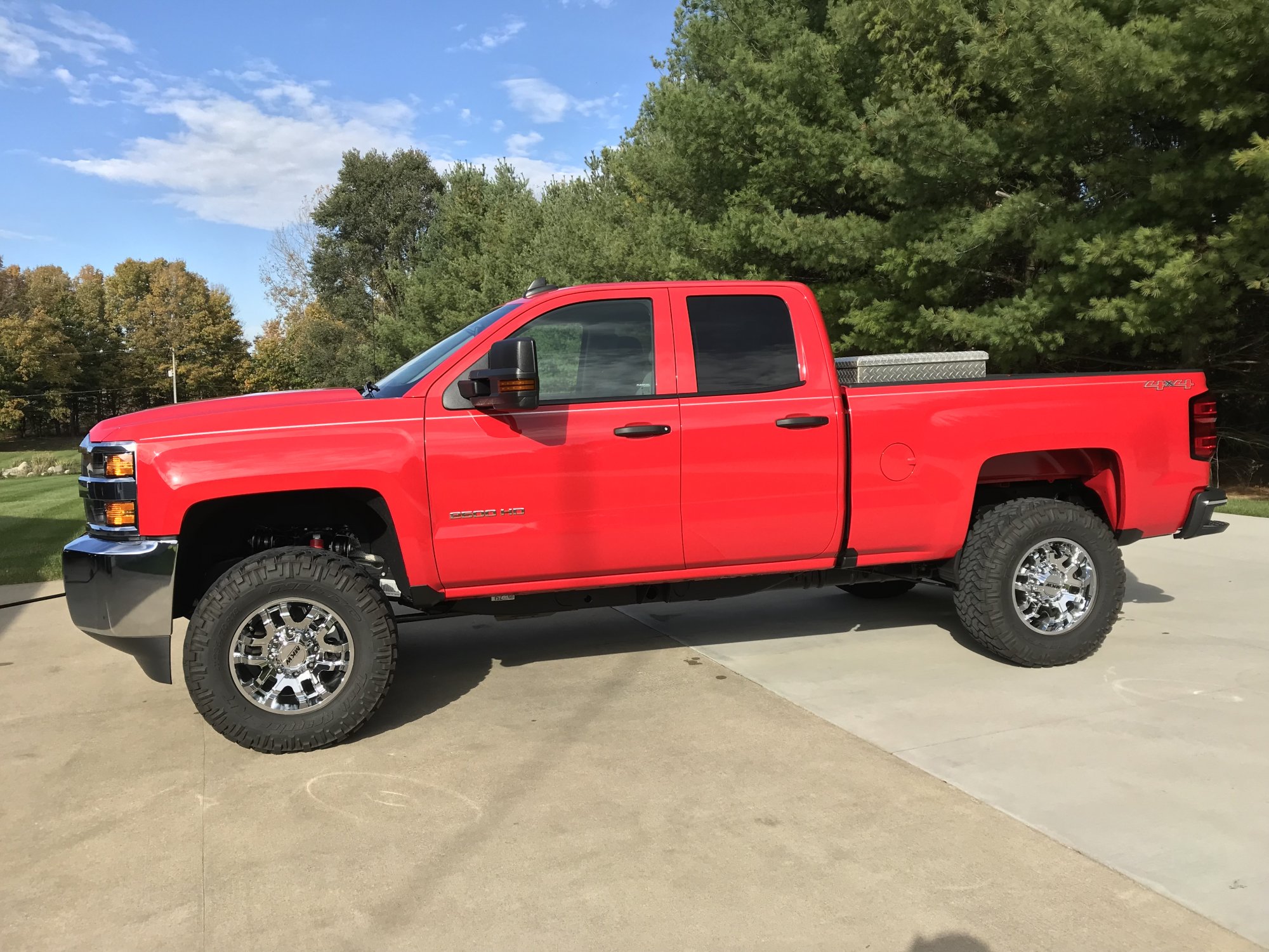

I installed a rancho leveling kit with new tortion keys on my ‘17 2500 HD. The kit I bought came with new longer rancho shocks. (eBay $215) Rancho # rosrs66351r5, the kit says you can run 33” tires but I have 34.5” (295/70r18)nitto mtr’s with very little rubbing on inner fender liner on full turn. Pretty easy to install and the ride is not really stiff. Need a tortion bar unloading tool to do the job yourself. Either way you lift it you should get a alignment after so you don’t chew through your tires. Westy5
