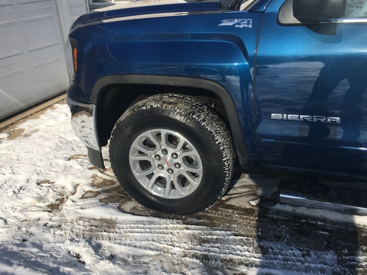

Got the new Michelin LTX AT2s installed and so far I like them fine.  Road noise is about the same as the Bridgestones, maybe a tad louder but still reasonably quiet.  Ride is softer and you can feel more contact with the road.  Traction is worlds better in dry, wet snow and ice.  As a bonus they fill out the wheel wells better too.  Should I have the front end alignment rechecked?  I had the alignment done back in March when the truck was newer.
