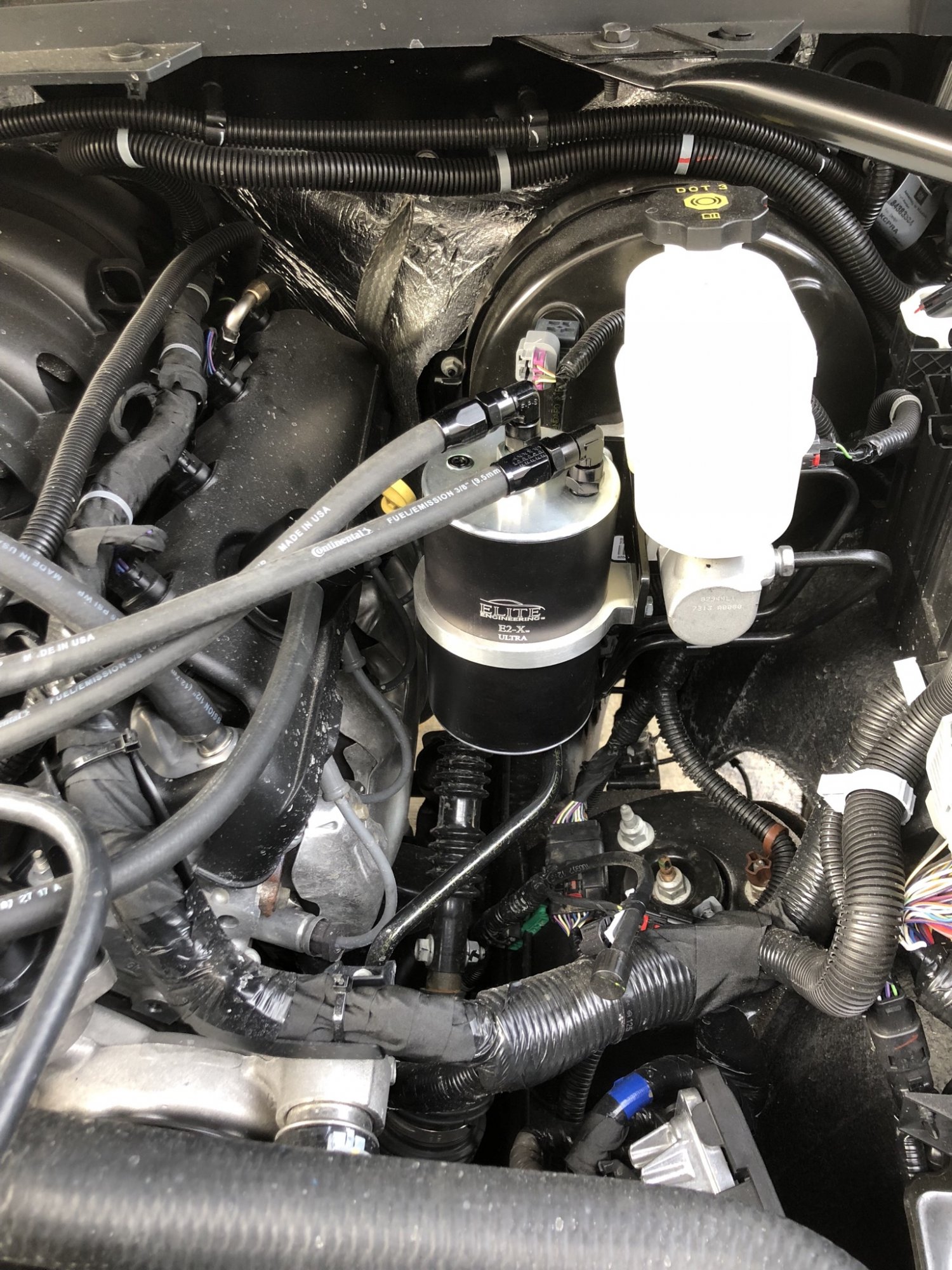

I believe the e2x is different internals as well that’s supposed to catch more. I’m running the e2x ultra and clean side seperator.
Nice picture......I think I'm gonna go with the E2-X.
Do you ever have to (or have the desire) to disassemble the E2-X for inspection/cleaning?
I’ve only had the can on for about 1,000 miles so far. Just hit 2000 miles on the truck, I drained it with the valve on bottom before. Have not ever opened the can nor do I think I will.
The Clean Side Separator is only beneficial if you're on the gas a lot such as towing or just fast driving. Otherwise, you're pulling vacuum which always will go through the PCV system which will pull from the intake manifold. Mounting near the brake booster will keep it hot enough for the condensation to evaporate and go back into the induction system (which is fine). That way the can won't fill up quite as fast either. I have the E2 without the CSS and it does a great job. I wasn't a fan of the pedcock valve on the bottom of the X cans as it's just another place for a possible leak.

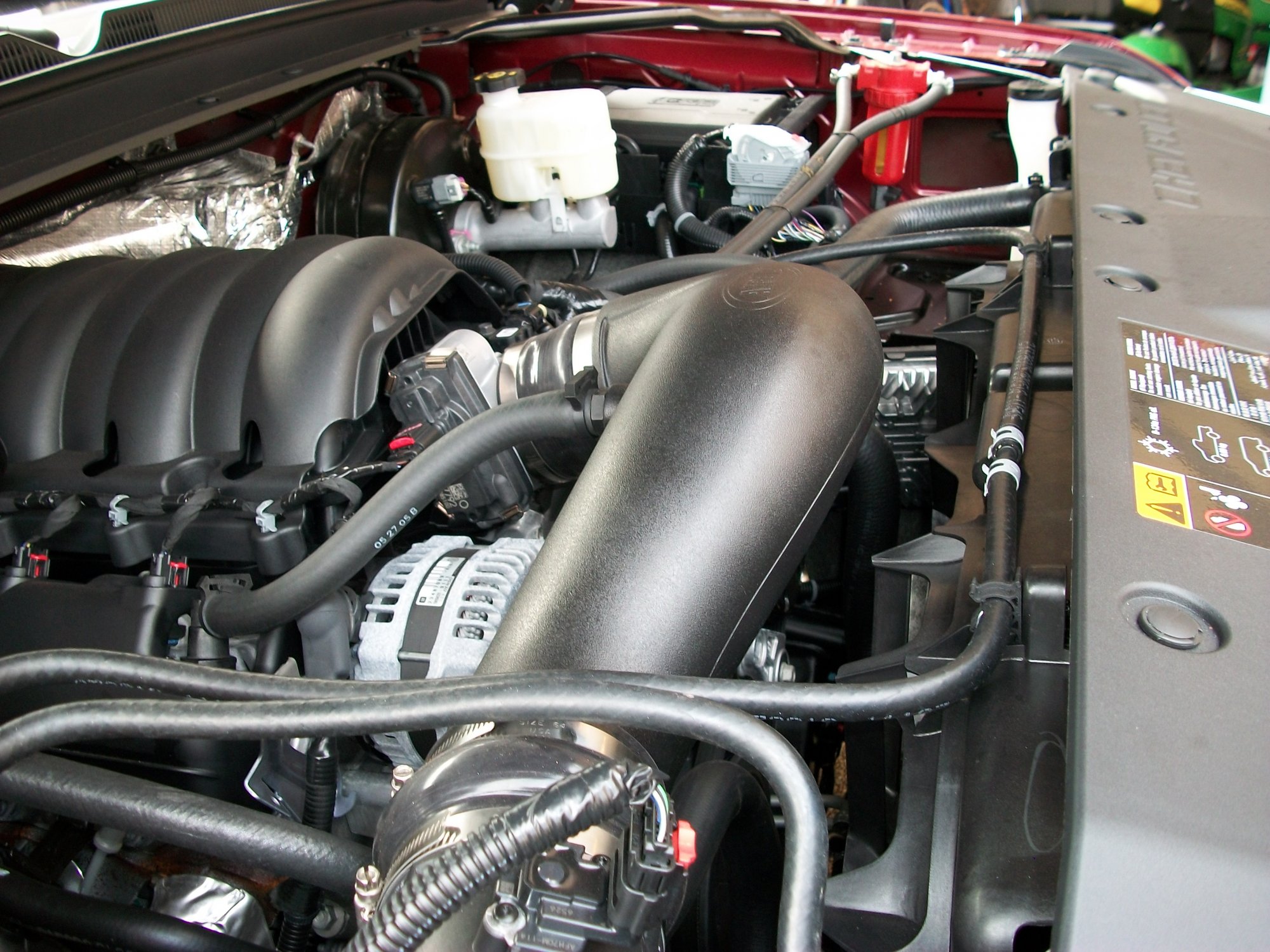

1.  I like the one I have: ebay ADD W1 replica for $40.  Pulled 2-3oz out already in less than 500 miles.
2.  I made a bracket from metal stock to mount on the brake booster bolt.  I have no problems with dipstick access.
3.  NAPA/Carquest transmission line is more than adequate.  I went to my local hose shop (you probably have one too) and got some gray cloth braided line for about the same cost ($4/ft).  Their trans line was $2/ft but the line I got looked and felt killer.  I had to have it.  Basically, check your local hose shop first.
4.   Since I put on a CAI, I was curious about the 'clean side' tubes reverting oil back into the intake tract.  I've checked the inside of the tubing several times, including after several 0-80 WOT blasts in succession.  I also tow regularly.  Not a smidgen of oil in the tubing or on throttle body.  Because of that, I believe the clean side separator is not necessary (for me anyway).
