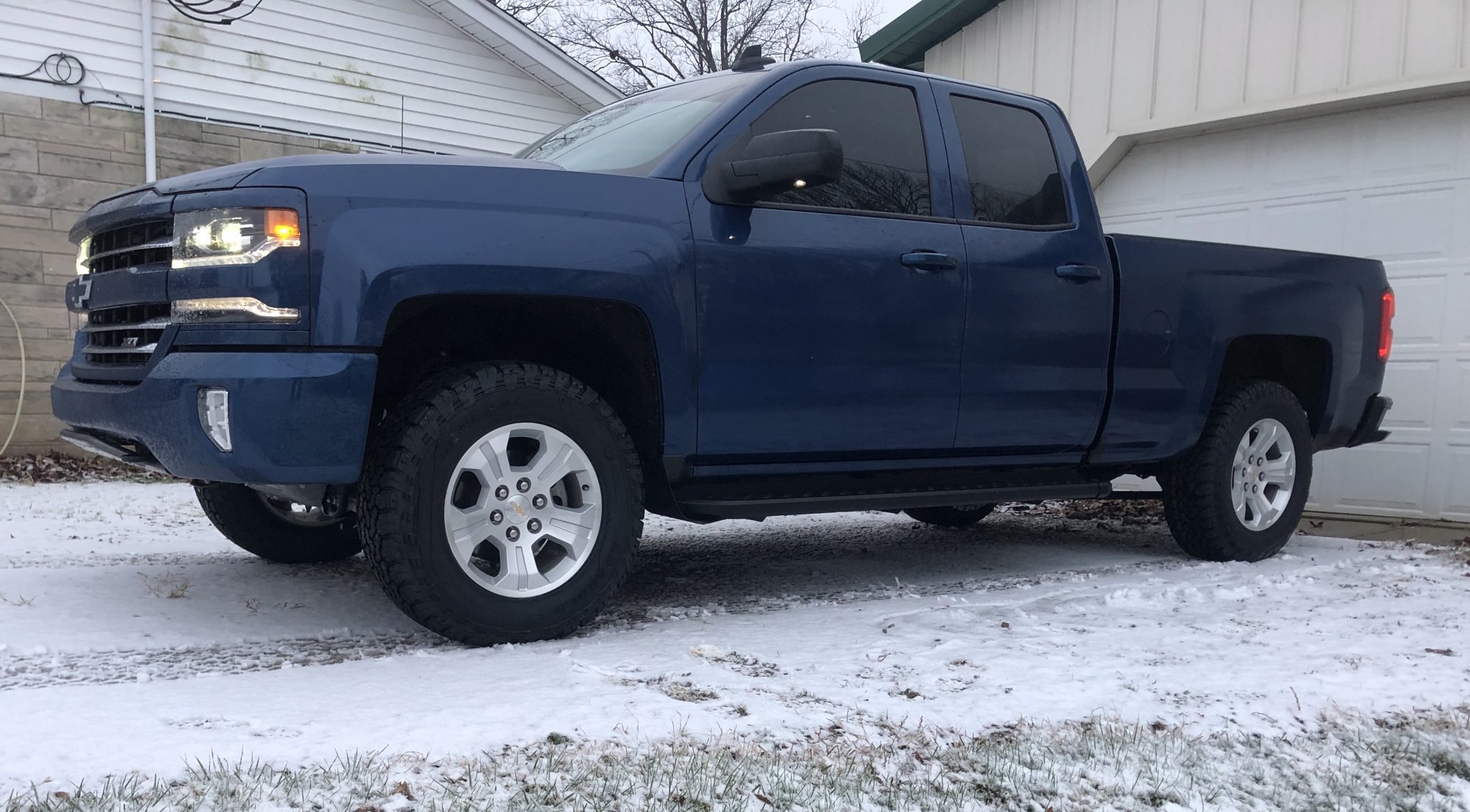

Just traded out of my NNBS Sierra into this 2018 Silverado. Went with 2" level with factory 22s, and 305/45-22 Terra Grappler G2s. Better pictures to come
Looks great... any rubbing?
Only if at a certain angle at full lock. Has 1500 miles now and has rubbed maybe 3 times

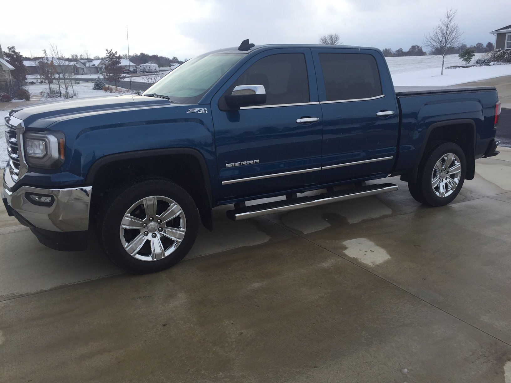

Installed Bilstein's at the top notch.  Raised the front as advertised, just shy of 2".  Rides fine. Still about a 1" rake from front to back even tho the picture doesn't quite show it.  I'm good with the stance and happy I used the top notch. 2018 Z71 with stamped arms.  Stock size tires for now.  Plan to upsize to 33"
