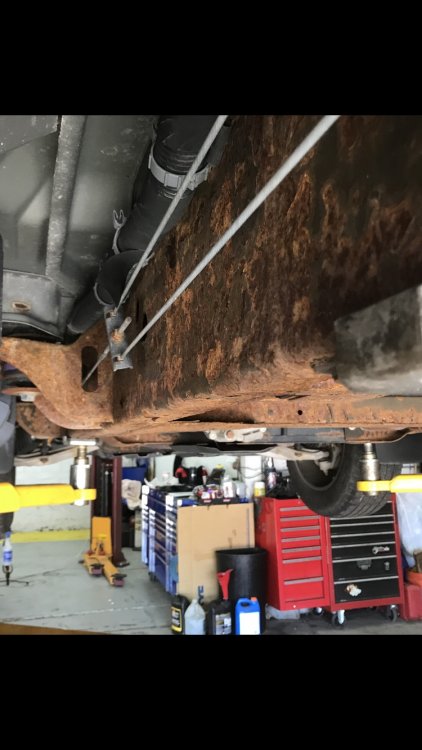

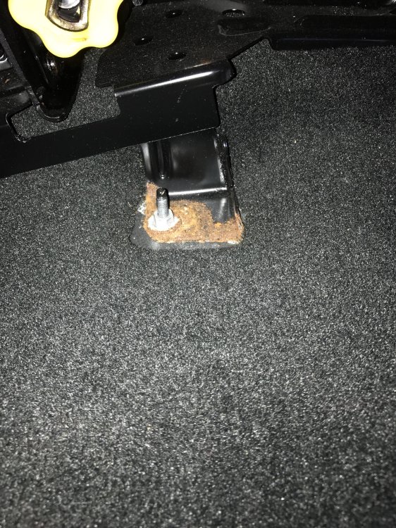

I purchased a 2014 Sierra that had a Sym-Tec system installed. It doesn’t appear to have been effective at all. The amount of rust on my frame was so excessive that it required grinding/stripping and a rust converter just to be able to treat it with POR-15. There was also rust in the interior of the vehicle around the bolts where the rear seats attach to the floor.
I wouldn’t be surprised if someone smarter than I figured out that my frame was actually acting as the “sacrificial anode” referenced above.
I want to remember that it's not effective because the truck is insulated from the ground...you need an earth ground and a decent anode, which are lacking in these systems.

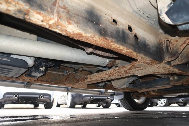

What part of the country are you in, obviously where a lot of road salt is used. I saw a 2013 Silverado a couple years ago on a dealers lot here that looked just like that. Car Fax showed it was from Ontario Canada.
The trucks original owner lived in Canada. I’ve almost literally found salt (or whatever they use up there) in nearly every exterior crack and crevice. It makes me think he worked in a mine or was hauling/delivering it.
That's how most of the trucks look up here in New England.  This is why I refuse to drive mine in the winter
