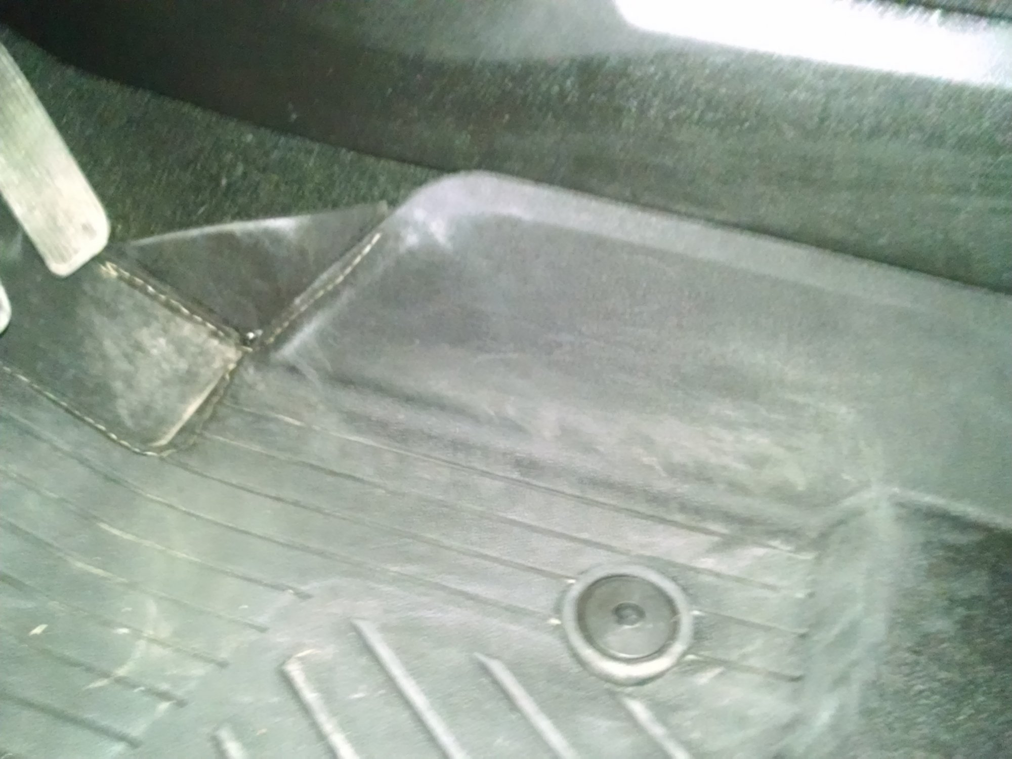

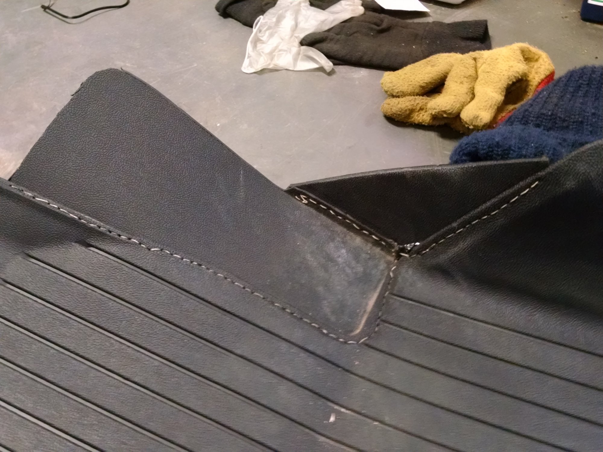

Finally added vinyl pieces under accelerator pedal on my drivers side GM floor liner. Took less than an hour to sew them on, and I now get NO dirt at all on my carpet !

Where did you get the extra pieces and you sewed them on by hand? How hard is that?
I cut the pieces from the rear seat floor liner. It goes way under the under seat storage bin. I sewed it with a sewing awl made for upholstery, and it was very easy.

Just FYI -- others on this forum have trimmed the sill part and used that extra material as well.  If you flip the liners over they are scored with a cut line that still lets the liners cover part of the sill but you can cut them out so they don't cover the logo on the sill.
