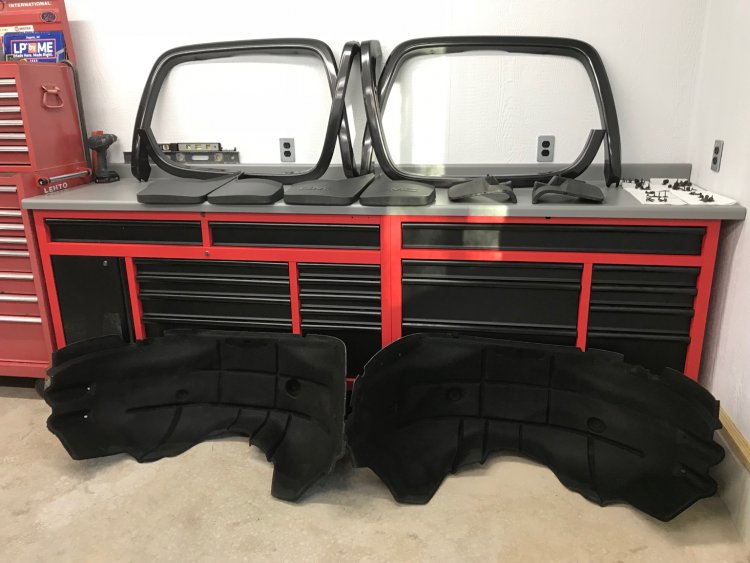

Gotcha I have never had a gmc only been on Chevy side. Last weekend I tore down my two week old truck and rustproofed it with a wax based rustproofing. My wife thinks I’m nuts she walked in and door panels, lights wheel liners and piles of plastic plugs around. I told her if we plan on keeping this truck I’m going to do everything possible to keep it rustfree and as nice as possible.  Make sure you clean out where your taillights are the pockets behind there collect everything.
