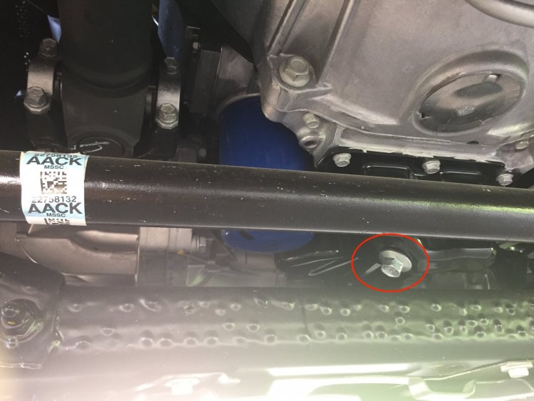

I'm 99% certain I have the oil plug identified correctly - circled in red on the attached pic.  I'm considering replacing this with the Fumoto (new generation valve - https://www.fumotooildrainvalve.com/f107sx.html) to aid collection of oil for Blackstone analysis and curious if I should still be concerned about possible errant opening if driving through brush even if I use their included clip?   (Generally not an off-roader.  But do have some acreage and occasionally drive through tall grass/brush in the pasture or side fields hauling a small Kubota on a car hauler.)
Also, does anybody know why the cross member directly below and towards the front of the truck from the oil plug has all the raised bumps covering it?  It also feels oily even though I could find no evidence of leaks above it.  The truck is only a few weeks old and only just turned 1,000 miles.
I would think it would be fine since the valve is above the crossmember.  The Fumoto valve is the way to go.  No mess changing oil from pulling the drain plug.  Plus I like to change the oil right after coming off the interstate when it is good and hot.

In terms of the 2 designs, as I understand it, the older design was/is a single casting so the orientation of the open/close valve is just whatever it happens to be based on where the threads land it once fully tightened.  The newer design I purchased (the F107SX for the 2018 5.3) is a 2 piece casting which allows the valve control handle to be placed in any orientation relative to the oil pan regardless of where the threads reach fully snug.   The newer design is also supposedly going to drain faster.  The most frequent criticism I noted on the original Fumoto valves was that they took a long time to drain.
As bushleaguechew mentioned, at least for the 2018 5.3 V8 the oil plug is NOT recessed so the adapter isn't applicable.  And the valve isn't close to the ground like it would be in a low riding sedan or coupe.  It also isn't on the very bottom of the pan pointing at the road, but angled on the side of the pan near the bottom.    Finally, it's higher than the crossmember it sits close to as seen in my original post's picture.  (The crossmember being the dimpled bar - drips from the anti corrosion dip they put the frame through.)

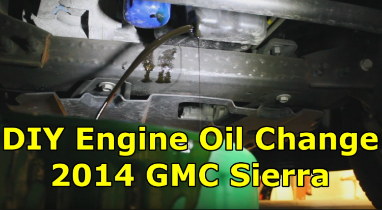

GM must have changed the drain pan at sometime because the drain plug location looks different than the one on my 2014 5.3 The OP's pic looks like the plug is almost at a 45 deg angle. Mine is more on the side (90 degrees). Found a pic off a YouTube video for comparison:
