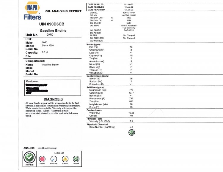

This is my first UAO on my 21 Sierra 6.2. Bought a couple of the Napa kits, analysis was done by ALS labs.
Total miles on the truck 5890 with oil/filter changes at 700, 2800 and 3044 using Mobil 1 AFE 0w-20  and Purolator Pure 1 filter.

Dennis, do they offer FTIR, KF water testing, and GC fuels dilute?  I know ALS can run them but wondering if they would for you.  That 2 ppm of Cr is ring alloy and should not be above 1 ppm for this engine even at low miles.  Might be worth it to get those readings even if it costs a few bucks.
