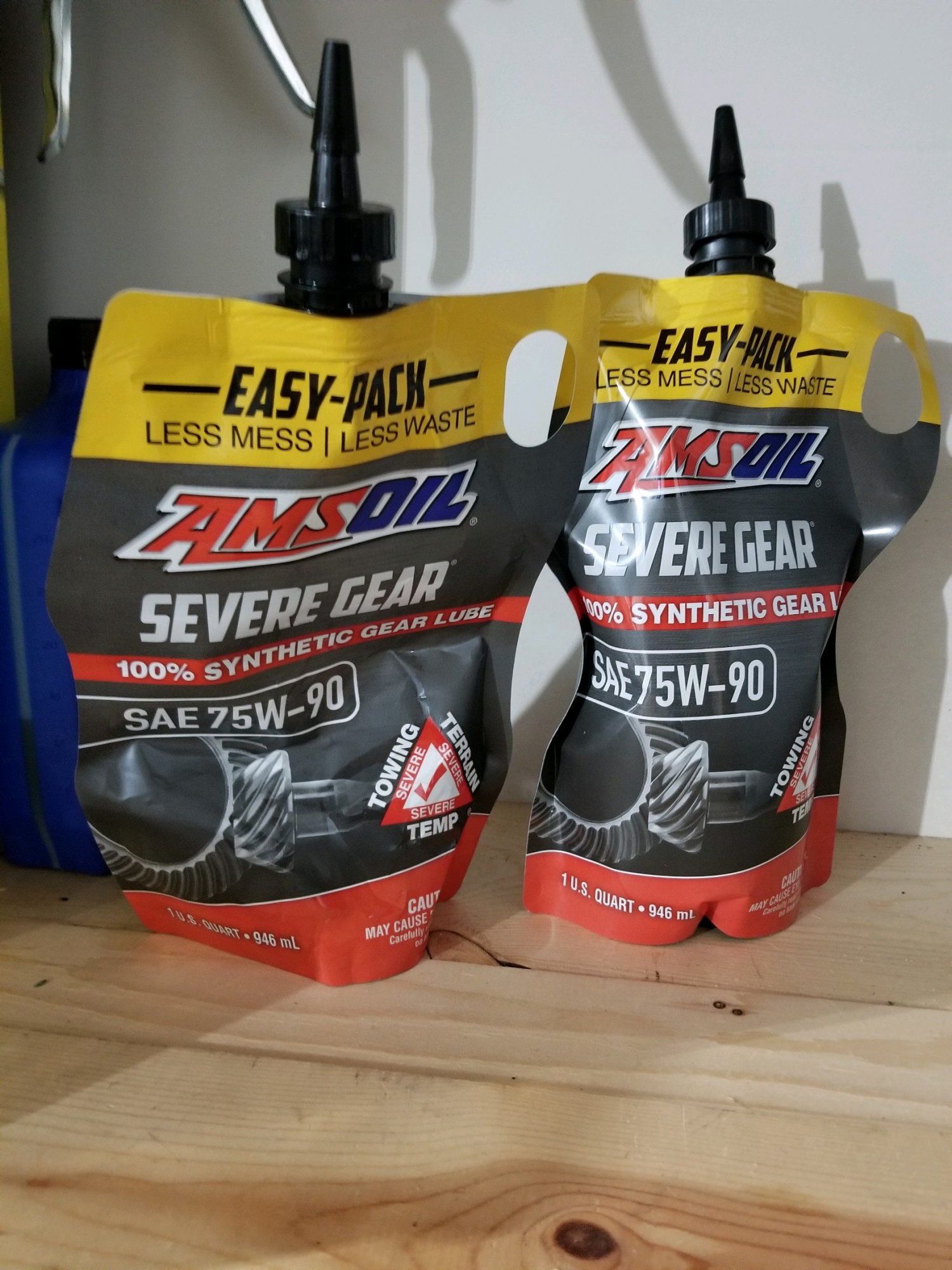

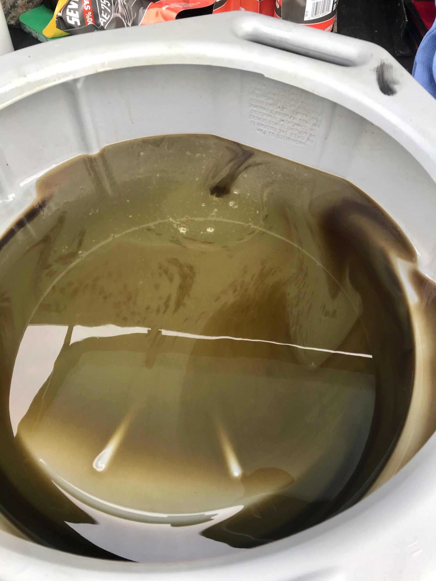

I bought my truck a month ago with 45K miles on it. Working through all the fluid maintenance needs right now but its cold as hell in the Midwest. Changed out the Transfer case with some AC Delco ATF and did the front and rear diff with Amsoil severe gear. Barely any sludge on any of the magnets. All looked really good. Rear diff looked slightly dark but not bad at all, front looked like chocolate milk, you can see the difference in the two fluids. Its my understanding that since the front diff isn't used as much it doesn't heat up like the rear hence the chocolate milk color. Any truth to that? I know the dealership changed the oil but they not only put the wrong tires ( not E rated) they also put the wrong filter on. So I don't trust any of their work lol. I bought a Napa Platinum filter and Valvoline 5-30 full syn was on sale for $27 for 6 qts. Figured its good enough until I figure out what I will run in this truck.
Great choice in the NAPA Platinum filter (Wix made) that is a good 5000-10,000 mile filter.  Great choice with the Amsoil front and rear diff stuff, I'm going to do mine at 20,000 miles.  Good choice also with the transfer case fulid change but even there I'd likely use Amsoil but no worries.  If you have the money and time, I'd also change out the power steering fluid, not very many miles on it, but get a good clean baseline on it anyway. (assuming you do have power steering fluid and it's not electric) Flush the tranny fluid every 30,000 miles too.  The flush will clean the filter/screen.
Edited by Colossus
Yes, this is normal for the factory front diff fluid.  I changed our 2016 Suburban out at 10k miles and it looked the same.  Sent a sample off and it came back good.  It is my understanding the color is from the factory using marking fluid when they assemble the differential.
Good choice on fluids.  :)
