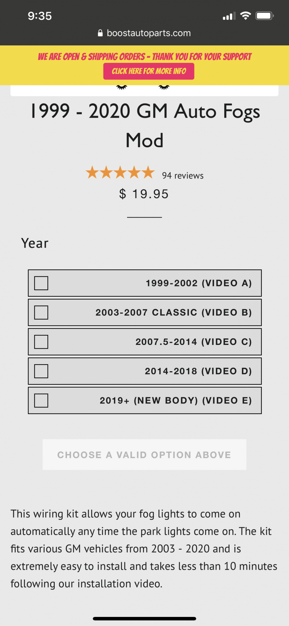

Ahhh crap, just went over the entire thread between us... I posted the wrong link.... the jumper I got was this one... I fixed the previous link
https://boostautoparts.com/products/1999-2020-gm-auto-fogs-mod
So, I just watched this install video and looking at whats included with the kit...any reason why I can't scrounge up a few pieces from inside my garage and make this myself? Its basically 2 quick splice connectors and 1 wire to connect the wires off the 2 identified pins? Anything I'm missing here?
