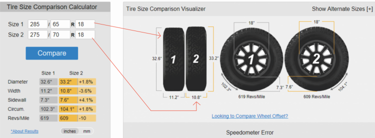

What would you rather have? 1/4" wider or 1/2" taller? (roughly)
Unless you are driving on sand, the extra width doesn't do much. I'm guessing you are going for looks, so pick the 275/70's for a bigger profile.

Not much difference. I'd go with the (ever so slightly) taller tire. Using this Link, you can see that there isn't much difference.

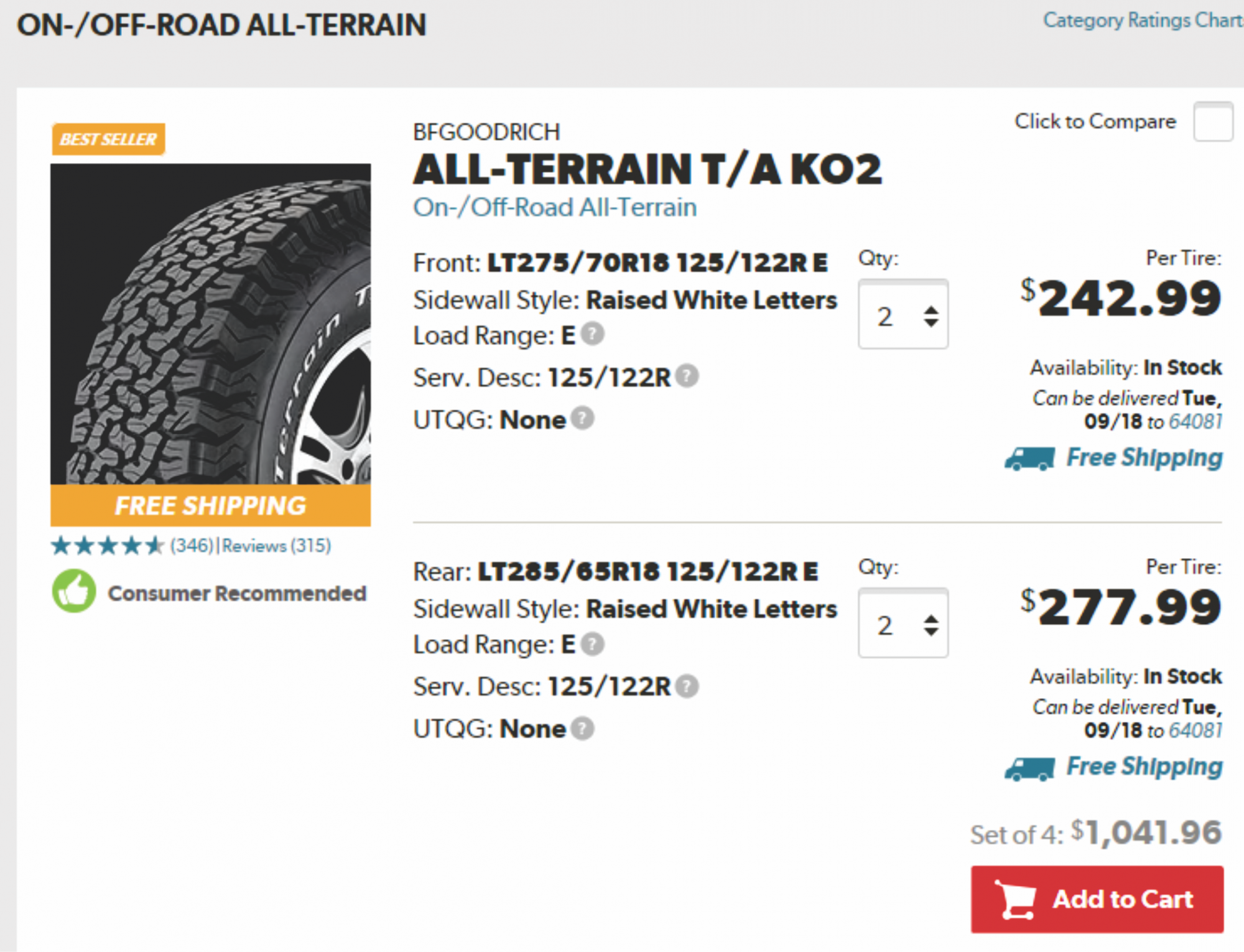

Is there a price difference?

Example below:

Example below:
For two tire sizes that are visually very similar, I'd buy the cheaper ones, to save the $140.  Looks wise, I prefer the taller tire, but we are talking about a less than 2% difference in diameter here.

In this Case the Taller Tire 275 70 18 is cheaper.
I'd say that's a win-win.
