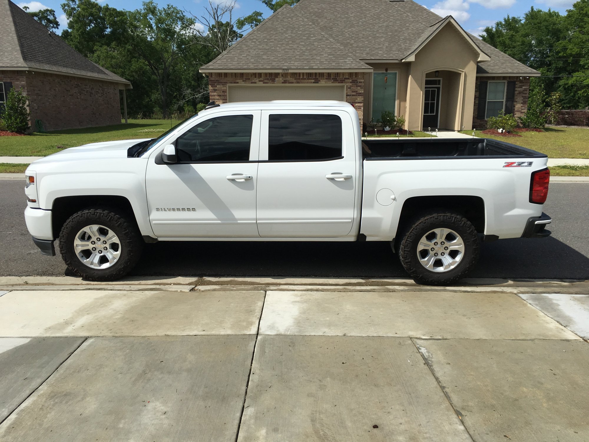

I bought a used 2017 Silverado z71 earlier this year that already had a leveling kit installed. Everything I can find leads me to believe it is only a 1" kit. The problem is I can not find anyone online that makes a 1in kit.

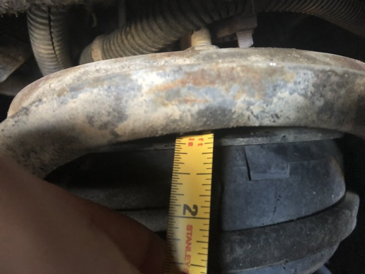

The kit uses a strut spacer on top. The spacer appears to measure 1" and I still have 1.5 inches of rake.

Honestly looking at your picture you posted, it looks just about stock, as if the PO took the level kit out?  Could just be the angle of the picture/proportion to the ground.

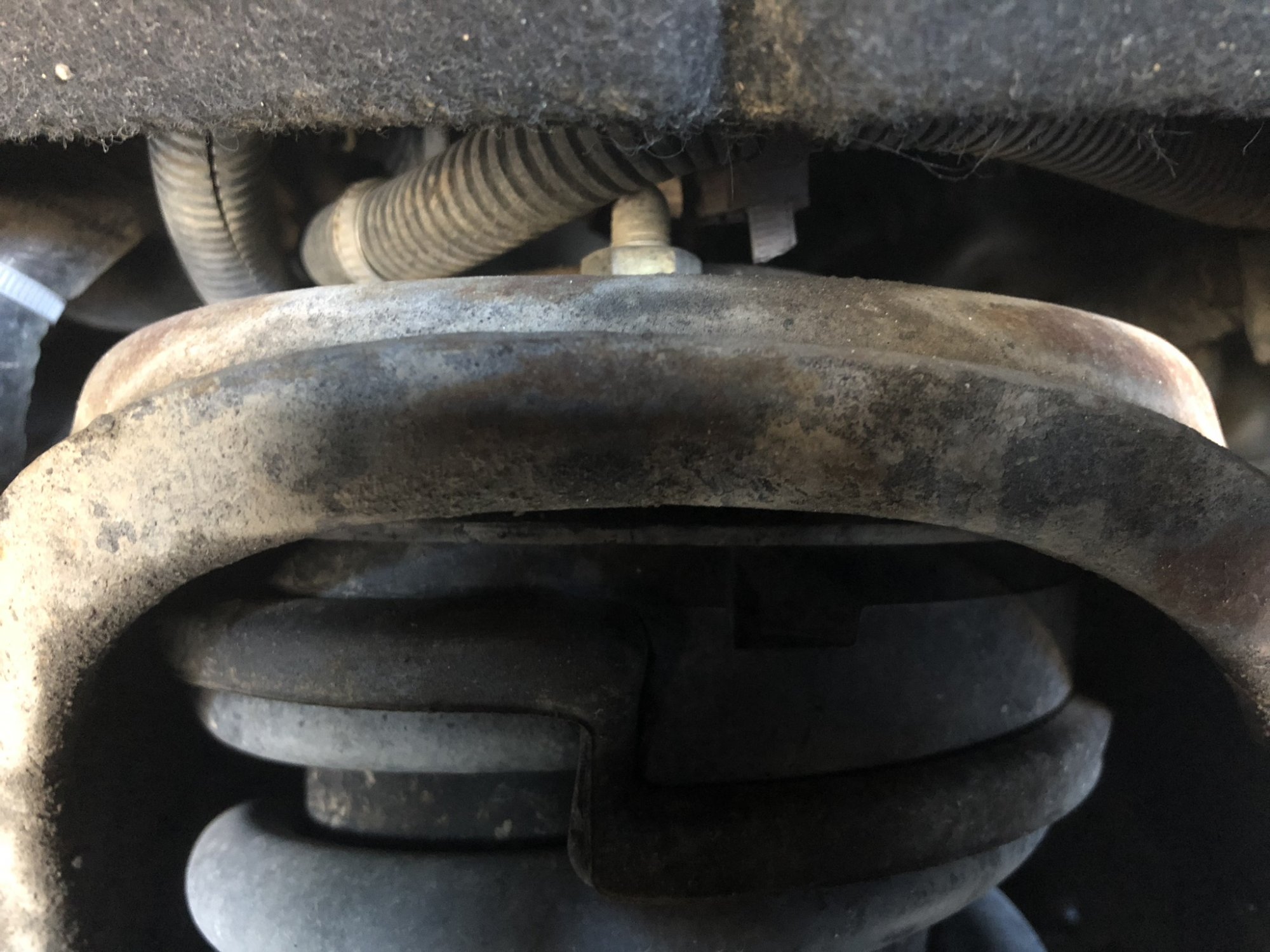

Got any pictures of the upper strut area?  Also, any rear blocks that don't look stock?
The picture is probably just an illusion. There is definitely a lift on it.  Just tried to take a few pictures. It was difficult with the wheels still on.  The rear has a small block, appears to be factory.
Here is another picture of the truck. Looks more level here...
I have the upper spacer. It is 1" thick but advertised as a  " 2 inch " level.
So Newdude is correct in the assumption of the ratio being 2:1 on the actual spacer thickness vs added lift.
Those pictures of the top of the front strut look stock to me. Here is what the top of my stock z71 looked like. You might try to find a part number on the front strut and see if it is stock or aftermarket with a built in lift amount.

Thanks for the picture of the stock components. The plate you can see on top of the shock is 1+ inches below the top of the bracket holding the strut.
There is for sure a spacer in there.

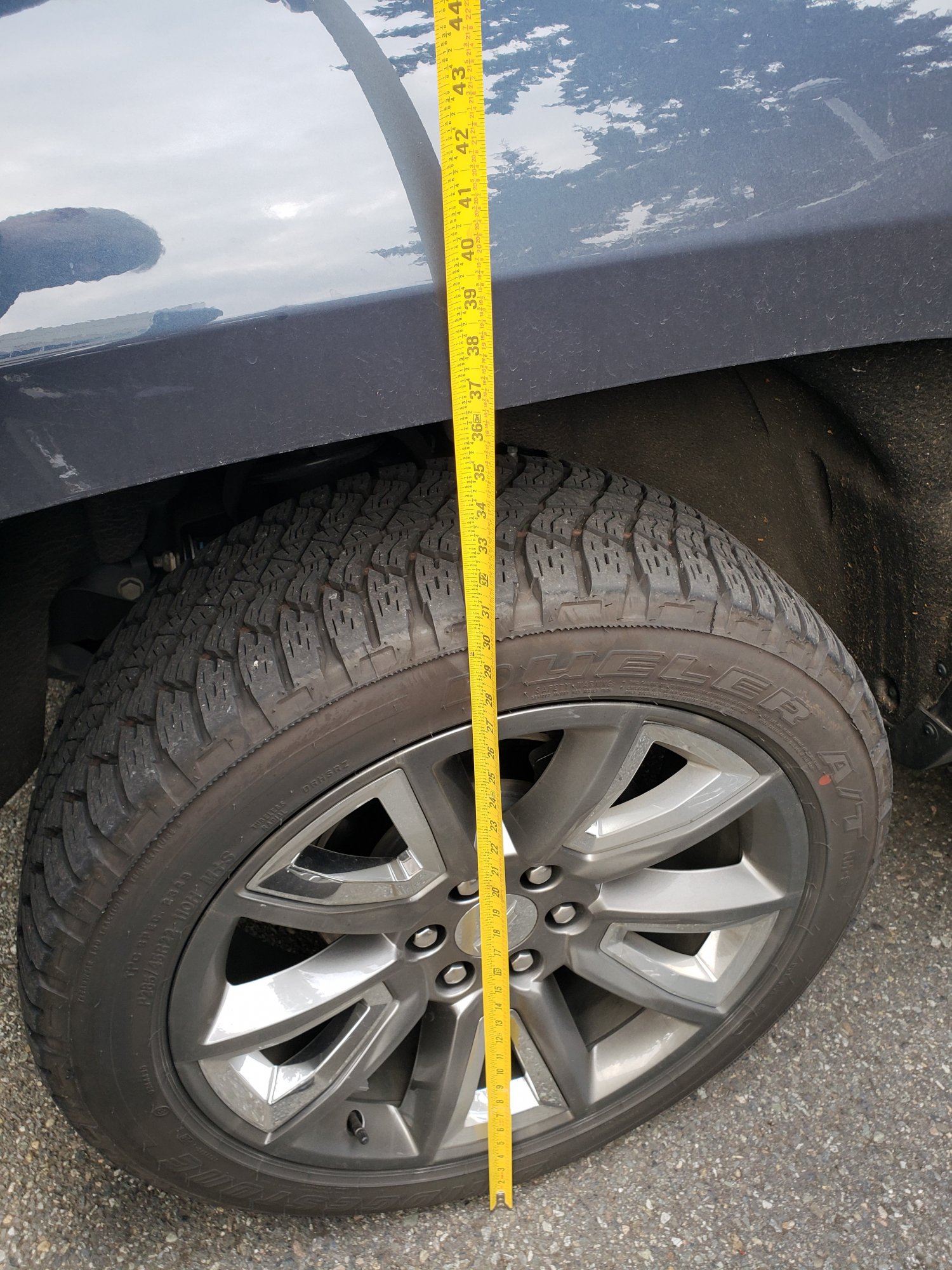

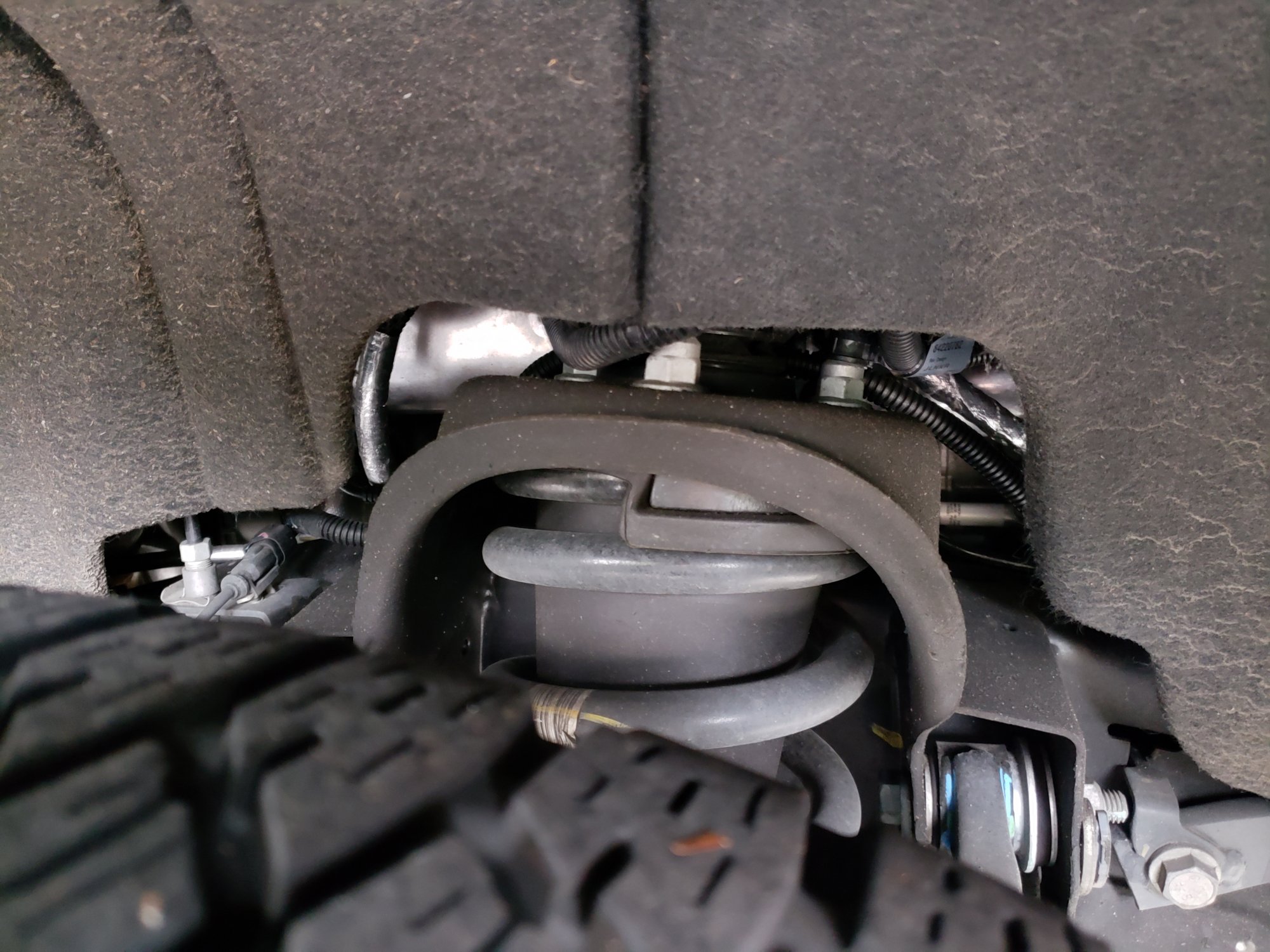

Yeah i'd agree it looks like something is in there as a spacer. I came to work this morning and found a 2018 Silverado 1500 Centennial edition in my same parking lot. Here is a shot of his strut. Ground to front fender was ~36.5"
