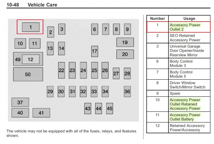

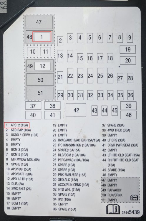

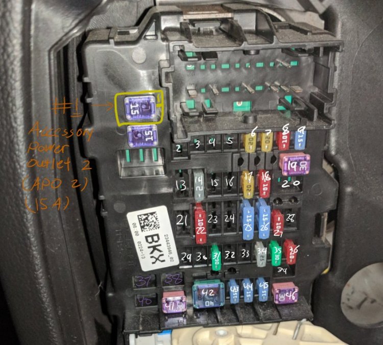

For the DC outlet (the one located above 110V AC outlet) , it was very simple fix actually, It wasn't fuse #35. It was #1 Fuse on the driver's side (see the attach files).
FYI, may be obvious but,  each power outlet has a separate fuse, their corresponded fuses located in both the driver and the passenger fuse boxes. My truck has 4 outlets which means they are 4 fuses for each one of them.
Thank you y'all for the help.
Glad to hear you solved it. Something must have caused that #1 fuse to blow, either an accessory drew too much power momentarily to pop the fuse, or there was a short somewhere. Keep a spare one in your glove box in case there was a short, but most likely a device you had plugged in at one point drew a little too much power. I used to pop them steady on my old truck that had an inverter installed to run small power tools. I went to a larger inverter that was hardwired to the battery and never had to worry about overloading the 12v socket again. Thanks for the detailed photos, it should help the forum users find what they are looking for when they encounter the same problem.
