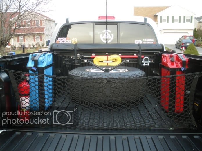

Wavian Jerry Cans are the best, blue and red cans in the photos above.  Get the real pour spout, not the government one too.  They're awesome.
