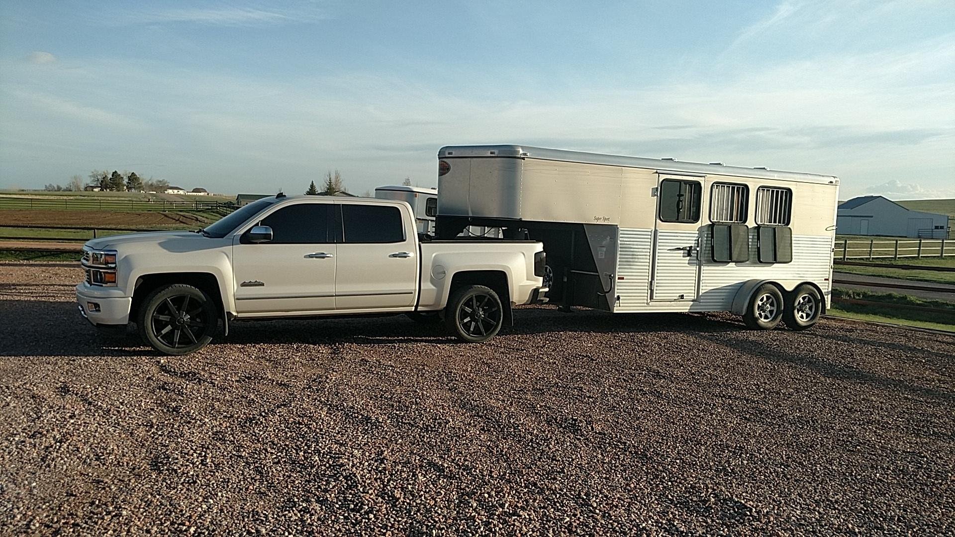

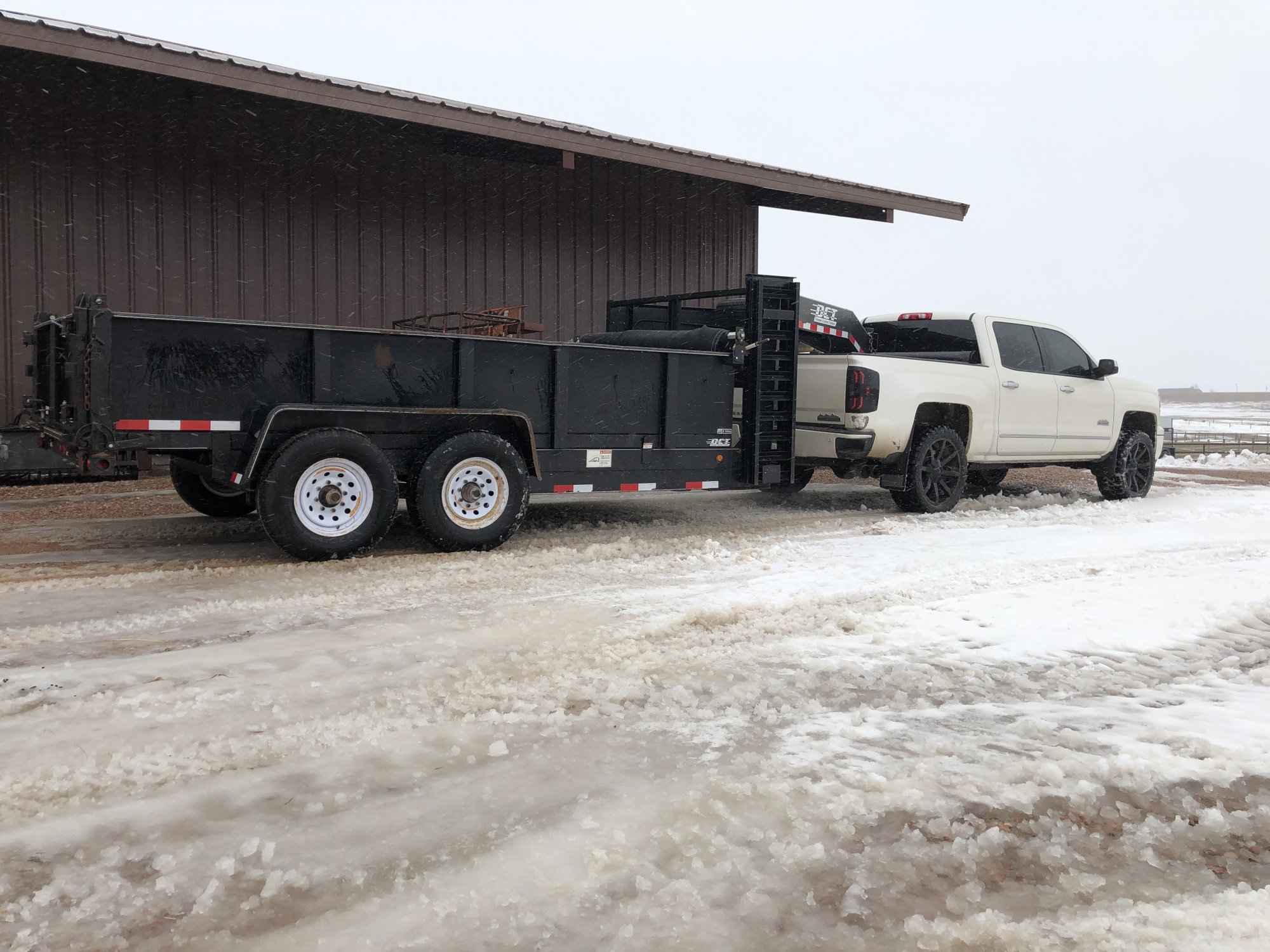

Who else has a gooseneck in their 1/2 ton? I have a 2014 Silverado High Country 6.2 with a b&w flip over gooseneck. Has been very handy and prefer it over bumper pull any day. I’ve towed a 4 horse trailer, a 16’ dump trailer, and a 20’ car trailer. I have the factory trailer brake controller as well as firestone helper air bags. Curious about who else has a gooseneck in their 1/2 ton.
Nice truck.
‘How many miles? How’s it been holding up?
Guessing your max towing is 9100lbs?
