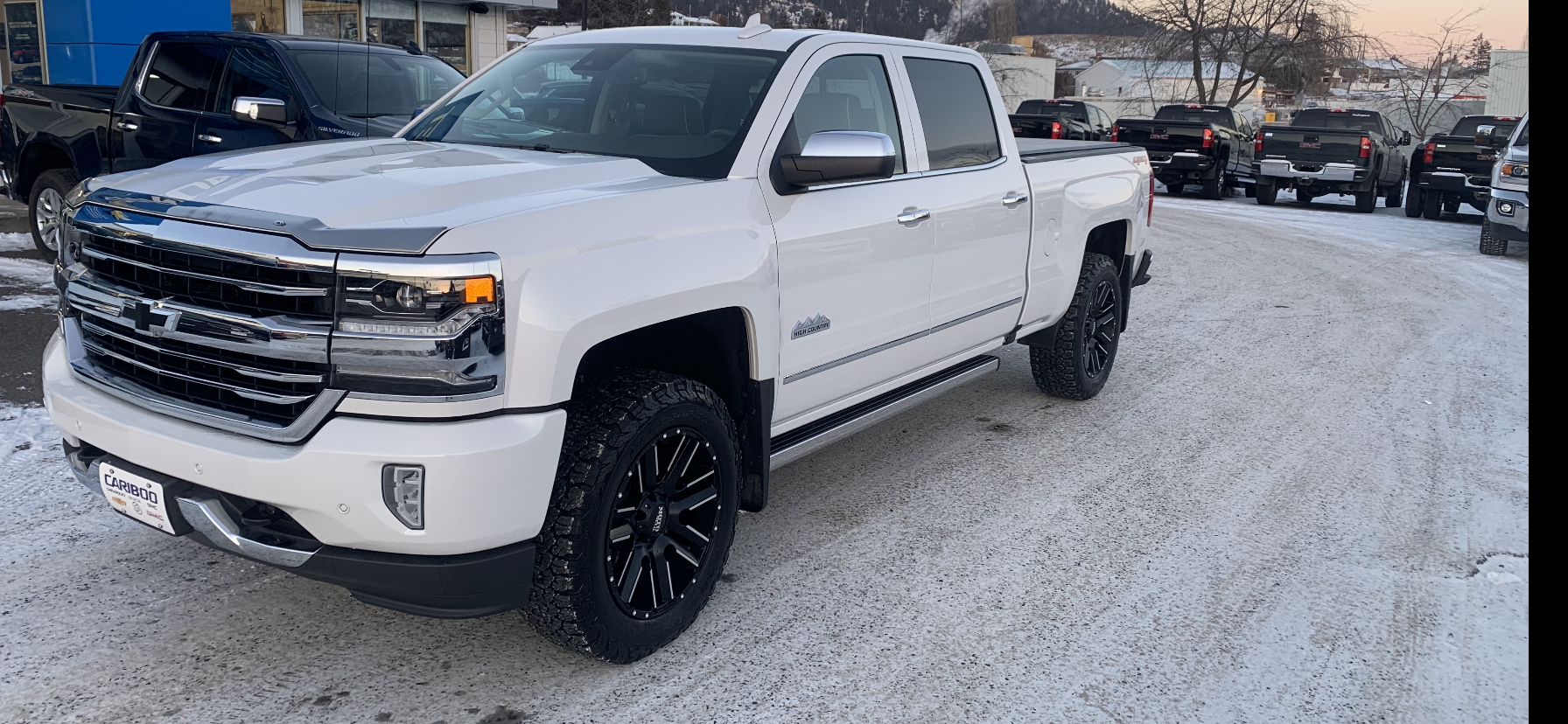

Sixtysix66 Posted February 6, 2019 Posted February 6, 2019 2018 Silverado HC 6.2 2”level in front 275/65/20 bfg KO2... just picked up today... love it

wepiii Posted February 9, 2019 Posted February 9, 2019 2018 Silverado HC 6.2 2”level in front 275/65/20 bfg KO2... just picked up today... love it Do you have any rub? Do you have the stamped steel control arms?Sent from my iPhone using Tapatalk
Sixtysix66 Posted February 9, 2019 Posted February 9, 2019 No rub at all... i dont know about control arms... i am gonna guess no... they would be stock unless they upgraded when i had level installed... but i didnt ask for it so i doubt they just did it... the level and the tire/wheel combo is great... head turner and lots of compliments
wepiii Posted February 9, 2019 Posted February 9, 2019 No rub at all... i dont know about control arms... i am gonna guess no... they would be stock unless they upgraded when i had level installed... but i didnt ask for it so i doubt they just did it... the level and the tire/wheel combo is great... head turner and lots of compliments Yeah it looks amazing. I just don’t understand how that tire fits with no rub. The stamped steel control arms are the stock part for 2018. My 2018 is rubbing bad with 275-60/20’s *** Nevermind I’m an idiot, I just realized you aren’t running the stock wheels. That’s why yours fit and mine don’t. Sent from my iPhone using Tapatalk
