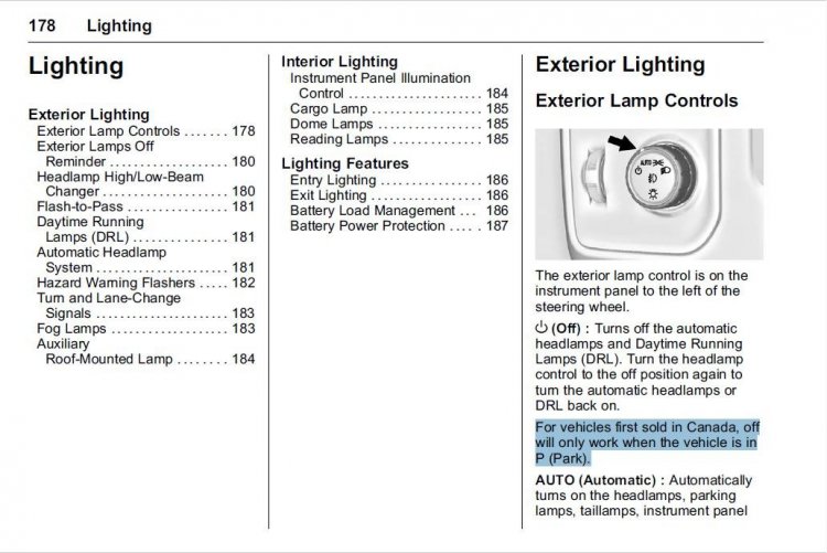

I recently bought a 2017 Sierra that came from Canada. I tried to turn off the lights to just the running lights and they wouldn't switch this morning. Pulled out the owner's manual and says right in there that you can only turn them off in park.
My question is: Anyone have a mod or work around to be able to switch to running lights when not in park?
We do a fair amount of camping and I always like to switch on running lights when pulling in at night.
