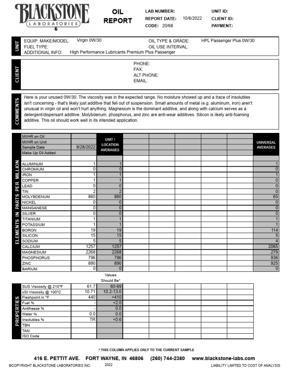

This is the VOA I got for the oil I'm running (premium plus pcmo):
Thanks wanderer. Boat load of additives. These cheaper clean reference samples make us want more.......and cost the buyer more over time.
Physical properties of Bklabs is wanting. We need 40C vis and VI calc,  FTIR, TAN, TBN, Karl Fischer water and OH bonds content and a baseline GC as diesel or gasoline reference to get some idea of aromatics content.
Blackstone is a mystery to me. They provide both dynamic and absolute viscosities for the same temperature but do not provide any acid or base information. They use 'close enough for horseshoes' fuel and water. They do not provide data on oxidation, nitration, sulfation and so on.... Looks like you're getting what you pay for but...... Point of the VOA isn't just to find the additive concentrations but to provide an entire reference library for VOA/UOA shift.
On the plus side they do provide historical wear data for your motor type and provide the average OCI length for that data. Something other labs do not do. While many will find fault in this practice as it is not YOUR motors history, I find it provides a point of reference for 'normal' for the type.
TR pentane insolubes = additive package before heating/activating in the engine.
Indeed, I agree. And you thought Red Line and MPT30K were additive rich :crackup:
Here is an HPL Euro (Supercar) 0W40 also missing key data but added Ox and N. @customboss do you recognize this lab by the paperwork?
Polaris labs based in Indianapolis but could be any of their contract services selling polaris under another name, Amsoil sends most of their customers  lab work there.
Bklabs charges extra for TAN TBN and any other testing they can provide. They have no FTIR capability.
@Grumpy Bear yeah isn't that SUS vis with cSt @100C interestingly a waste. Their viscometers are old school so they might be just taking SUS and converting it to share with customer.    Makes the customer believe they are getting two viscosities when its the exact same measure different standard!
The WIX Filters analysis is ALS labs work and dumbed down for consumers. They prefer to work only with businesses.
Well, isn't that interesting. Too lazy to measure density for an accurate cSt conversion from SUS. :crackup: They are just pulling it off a chart then and assuming a density of 1.00. :nonod:
Why they are proud to be the  " McDonalds "  of oil analysis....... quote from founder their father.
