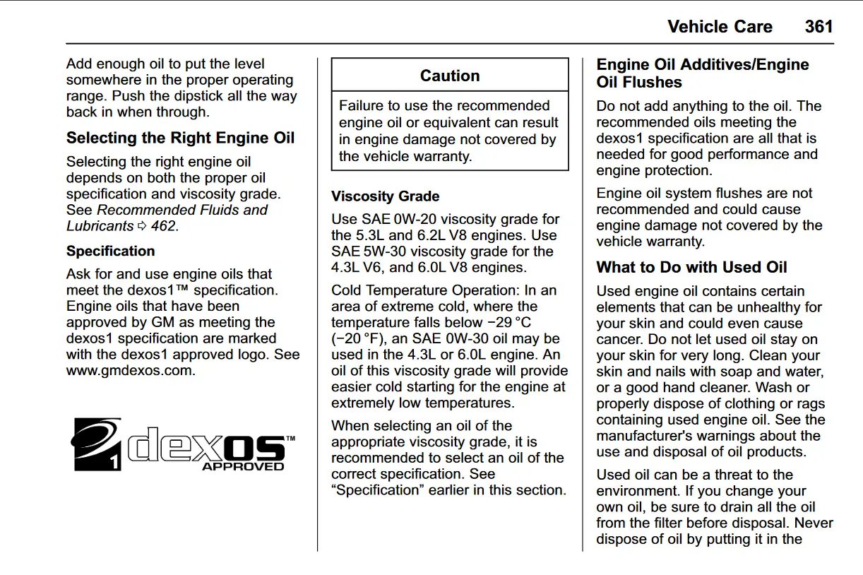

Any oil that is on the dexos®1 Gen 2 list will work just fine.  Most you can get at Walmart.  Just make sure it list dexos®1 Gen 2 on the bottle.  As for weight 0w-20 is the preferred weight according to the owners manual.

There's this magical little booklet in the console or glove box, usually referred to as the "owner's manual" that shows has the specs for the fluids, along with most everything else you need to know about your truck.  If there's not one in the truck, they can be found within about 30 seconds online. This screenshot is directly from the 2017 Silverado owner's manual

As stated just use the recommended weight and Dexos 1 Gen 2 oil.
