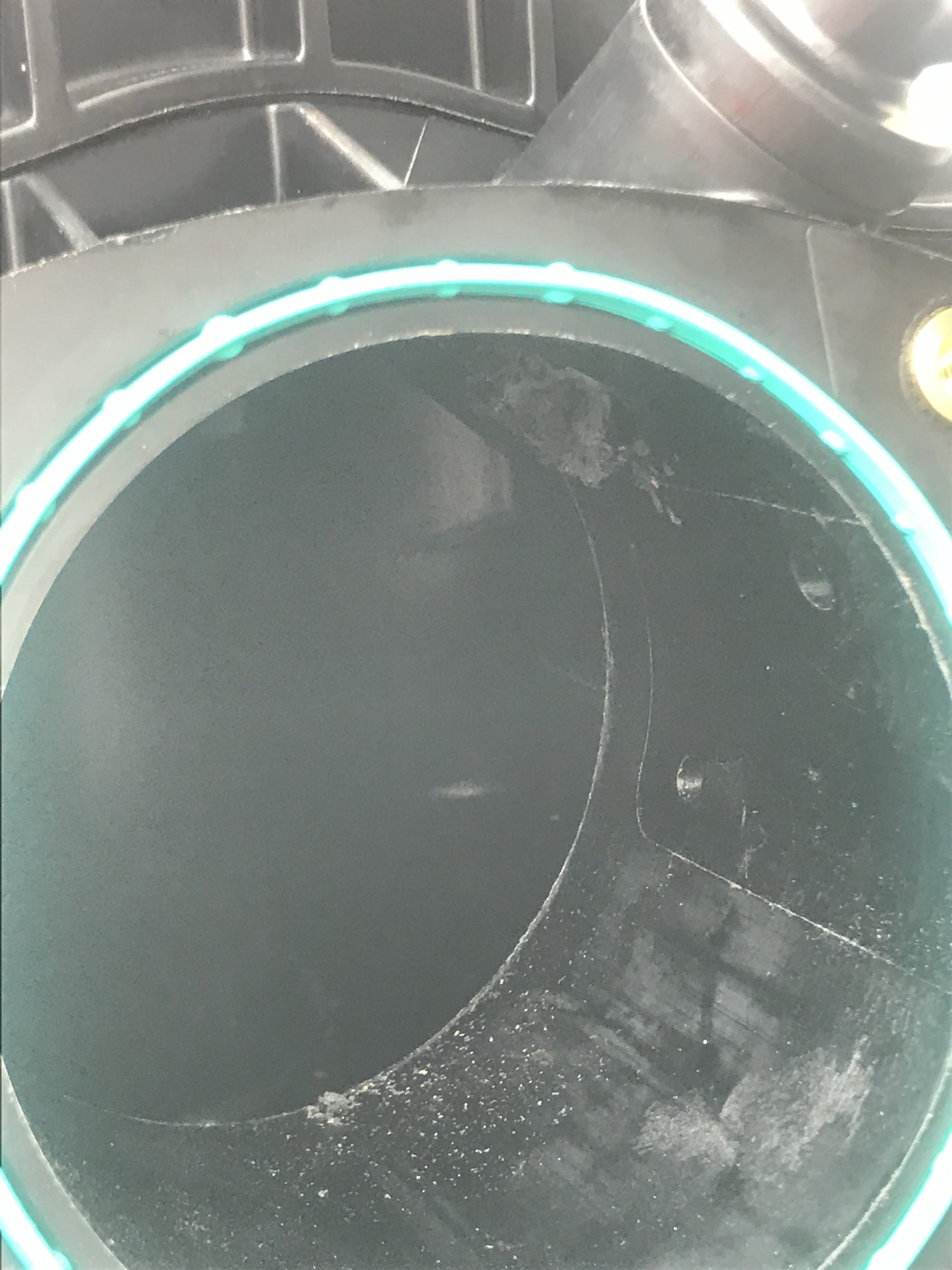

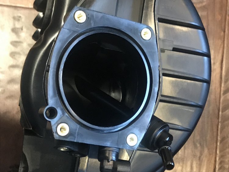

Do the thermostat delete mod on your transmission mine usually is 140-170 in summer heat . Now towing I don’t know yet we’ll see at the end of April going to Talladega race . I’ll be towing my 34 foot long travel trailer . I did order the l86 intake got that ordering the l86 Tb tomorrow. If you
look close I cut out that tube and sanded the mouth of the intake some .

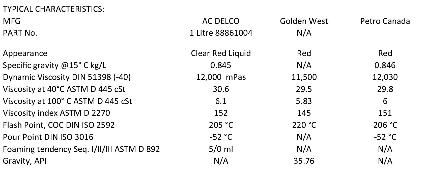

The fluid is fine at that range I did a bunch or research of about 7 brands of DexVI and it's a pretty neat oil spec wise. I have not moved on to the seals and clutch plates yet to look at the temperature rating wise its on my short list. I'm rebuiding a trans from the case up, so Im just curious for my build after I get it all back together.
If you download the fluid docs its actually the Low side they have seemed to focus on, cold weather seems to be much more of a concearn for these transmission's is the common theme I ran across, that could be a bunch of copy paste going on as well so they fit into the qualification group for "DEX VI". None of them were focusing on the high end in their description of the fluid, the specs are there for the high end.
Perto Canada had the most info for the fluid without calling them. (Im sure a quick call to any of these places just ask for a app engineer and they should have someone available to answer some basic info)
I wanted to know if the non OEM brands were the same and how different the actual specs are. This is as far as I got to actual compare the data....
But the fluid is pretty solid stuff. Seals and internals maybe someone else has some technical data on those.
The elevated temps do not appear to be an issue fluid wise,
