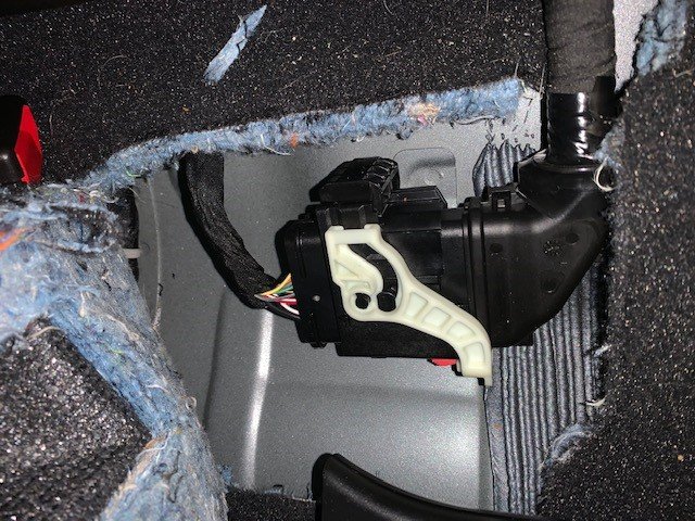

Would someone please help me with this connector? How do I disconnect it? Trying not to break anything. this is the connector under the bench seat console.Thank you
Edited by Recneps
Do you have the part number for that harness with that connector? I am installing a jump seat from a salvage yard into my custom. Trying to figure out the best way to connect the existing wiring harness (of the LT jump seat with the usb charger and cig lighter) to utilize those ports. Don't really want to run a random wire to a fuse box, if I can find an existing part number that this harness (PT # 84535195) will connect into.
