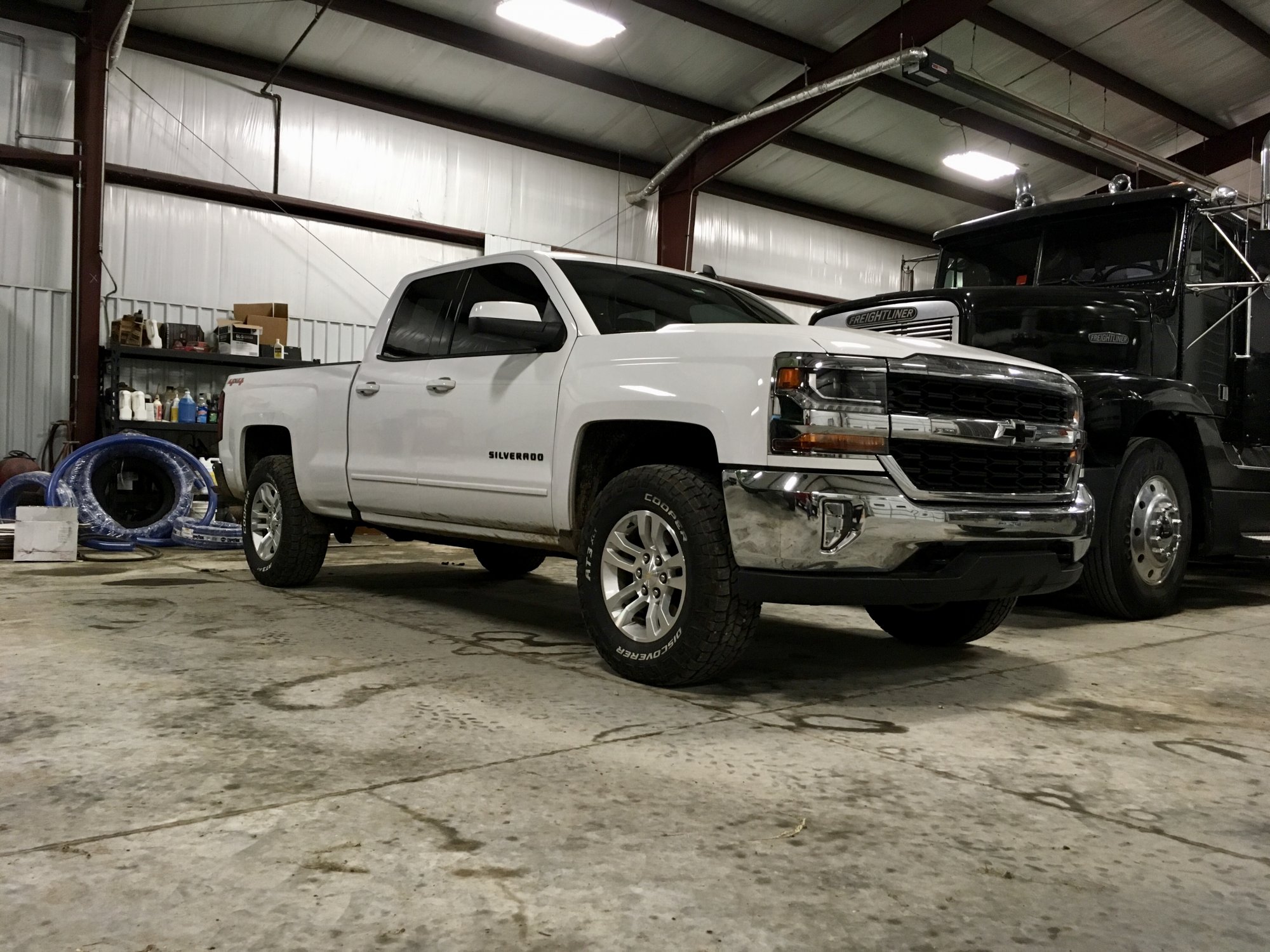

Thanks for the input. Sounds like I should do the rears soon. I've been very happy with the front. No regerts. I haven't really had an opportunity to take any good photos of the ride height but I'll toss one up. The front is still slightly lower than the rear, which I'm happy with.
