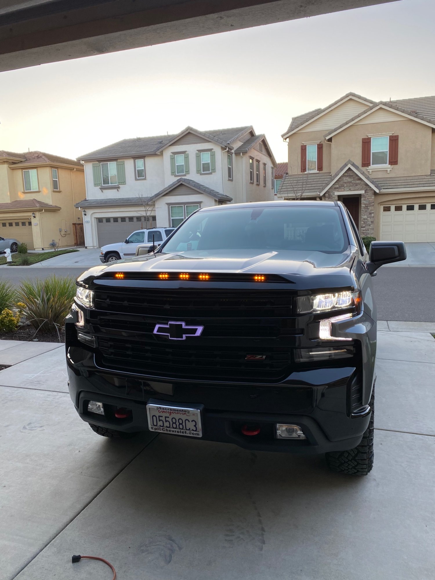

9 minutes ago, Shoup1cobra said:
I removed the headlight bulb and tapped into that harness. It was much easier than trying to reach the entire harness at the bottom of the headlight. The posi lock connectors and exisiting wiring can tuck in behind the bulb and then everything gets covered by the large rubber flapper.
Also, I tried the add-a-circuit in the Fog light fuse spot and had zero power. I don't have fog lights on the truck, so must be switched power or something that is preventing it from working. Just a heads up.
So that bulb has a connector with 2 black wires, is that what you tapped into?
Yes, they were both grey - if I remember correctly. I probably used my multi meter or a happy hooker to test for voltage.
Got it on. Thanks for the help my man! Much appreciated.
  • Thanks 1

Color matched on my Custom Trail Boss. Micro 2 tapped into 3 on fuse box. On all the time.
Is 3 high beams? So the avs lights will go on even if headlights aren’t on?
3 is head lamp left, will send power to the AVS light all the time.
  • Thanks 1
