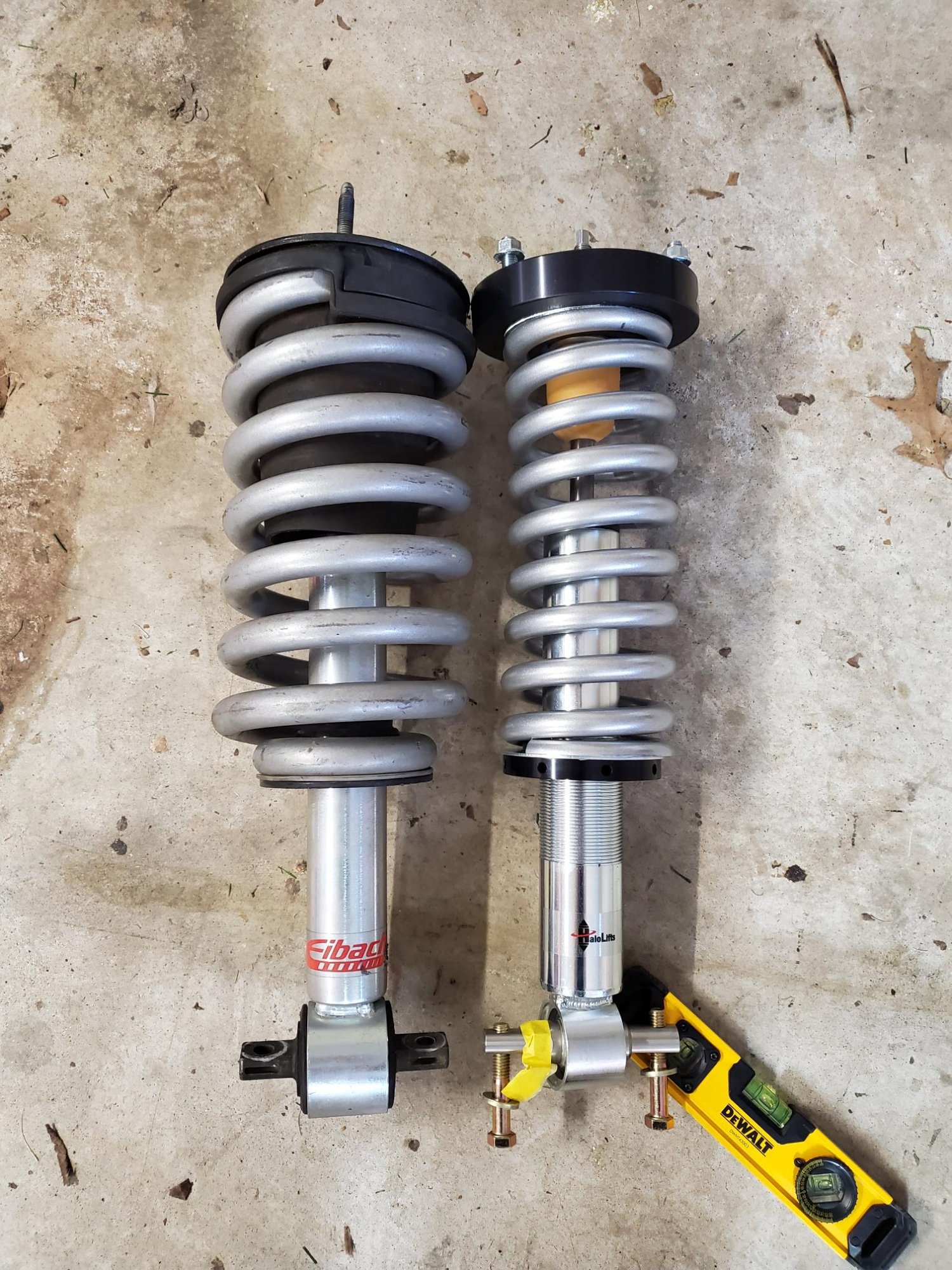

Maybe this help the original poster: I had the Bilstein 5100's at the stock setting with a Zone 2" Level Kit for 3 1/2 years.  When I decided to make a change, I went with the Eibach Pro Truck Lift which provides the Springs and Shock.  (You use the hardware from the original strut).  The ride was much stiffer than I expected at first.  I called Eibach to inquire about the Spring Rate and was told they 820# (10% higher than the stock spring which puts it around 740#.  I ordered and installed a set of Halo Lifts Boss Coilovers and the spring rate on them is 700#.  The Eibach kit did soften up a little after 1000 miles or so but I had already ordered the
Boss Coilovers.  You can see how beefy the Eibach Spring is on the left vs. the Eibach Spring on the Boss Coilover.
Even with the Coilovers installed with (2) spacers giving it a 3" lift rides better than the Bilstein or Eibach strut.  I am going to remove the spacers and drop it back down to a 2" lift because at 3" it puts too much angle on the other components even with new UCAs.  Theoretically it should also ride smoother at 2" instead of 3".
