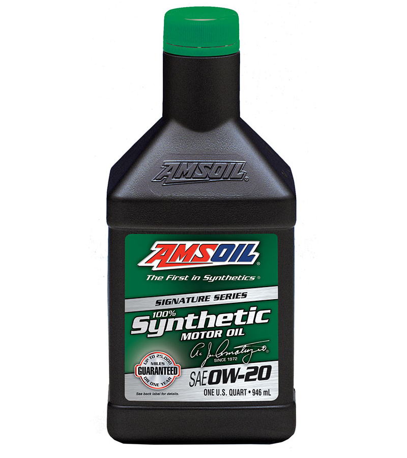

I noticed amsoil 0w-20 does not have the dexos approved logo on the bottle, but is a full synthetic.  Concerns?
