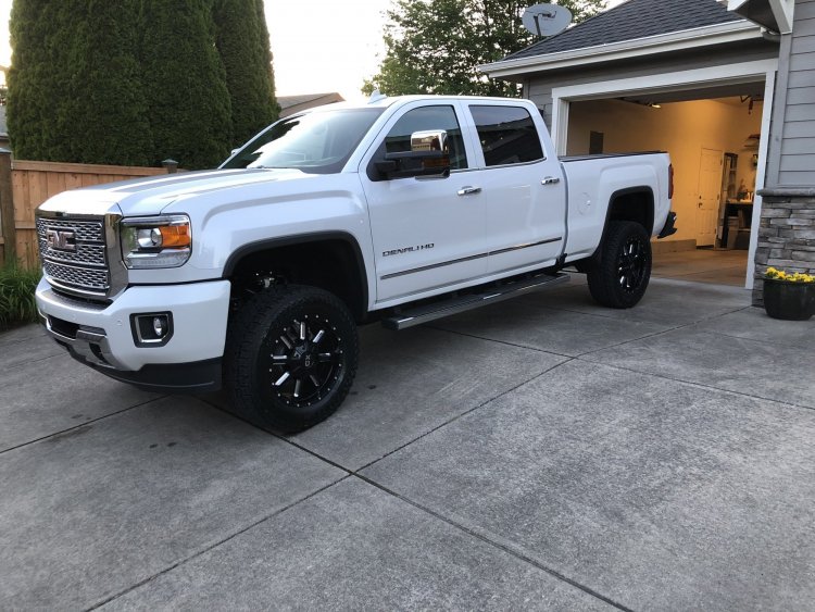

OK, probably my final "update" post to this thread.  In all, I ended up with the following:
  • 3" level using new keys
  • New upper control arms w/ limit straps
  • Front shock spacers
  • New tires (bigger)
  • New wheels (required to clear new upper control arms)
I certainly wasn't going to do all of this, it just kind of snowballed.  But all in all I'm really happy with the look AND more importantly, the ride.  Speedometer is off about 2-3 MPH, but I'm told not much can be done about that.
Got her all washed up tonight (just covered in bug guts from freeway driving!) and she's lookin' good if I do say so myself.
On 6/14/2019 at 6:19 AM, gearheadesw said:
Looks good @Riggin', glad you like how it turned out, good job.
Thanks man.  At some point (2-3 years if I keep it that long) maybe I will swap out for a full Zone kit, or something like that.  For now I'm pretty happy but in hindsight, I should have just done something similar to the Zone or Tuff Country 3" kit from the get go.  Oh well, live and learn.

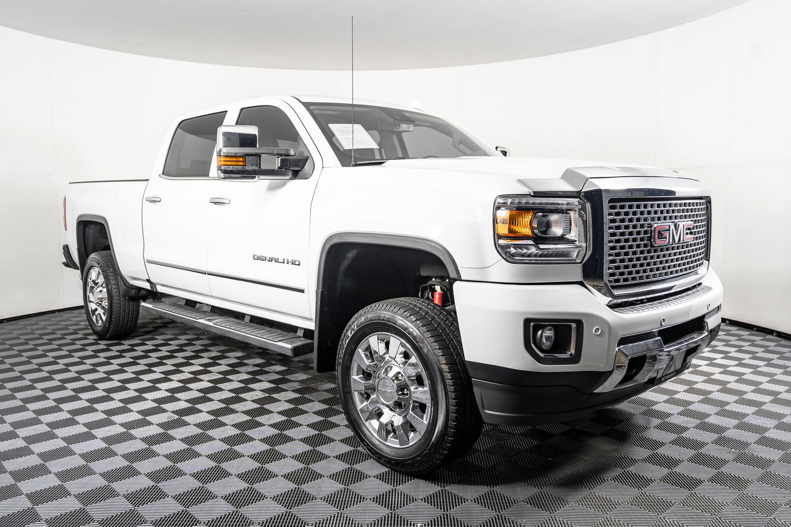

Hi, I’m new to the forum, I just got into a new to me 17 Denali 2500hd, looks very similar to yours Riggin’. They could be sisters. I love the look with those wheels. It would appear that they leveled my truck by just cranking the keys up. The front suspension look very similar to the original pics you posted Riggin’. I should have read up a lot more about these trucks and their mods first.
