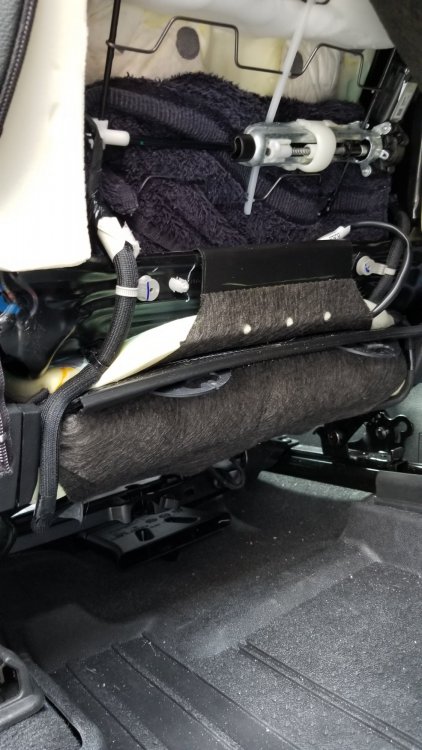

I'm still not having any luck on finding a solution. The towel and pad helped a little but not enough that they were worth messing with long term. One thing I found when looking in the seat is the lumbar adjustment is just a screw-drive with a cable. I've attached a pic. It's a little hard to see because I had already stuffed a black towel in there when I was messing around trying different things. The screw-drive is attached to the driver's right side of the wire mesh in the back of the seat. The cable attaches to the other side. The screw-drive is about 4 inches and is a solid piece. So when you power adjust more tension the screw-drive seems to pull against the back of the seat before the cable gets tight. I think this is what was causing me to feel like I was sitting twisted. On my friends F150 the lumbar adjustment is very similar except it has a plastic frame type piece between the cable and the seat foam. That more evenly distributes the pressure and buffers that pulling from the one side. Similar to the one pic I've attached. Just my thoughts.....
But again, no matter what I try I'm still never comfortable driving the truck after 5 months and 6000 miles and I really am trying to accept it since I love most everything else about the truck.
