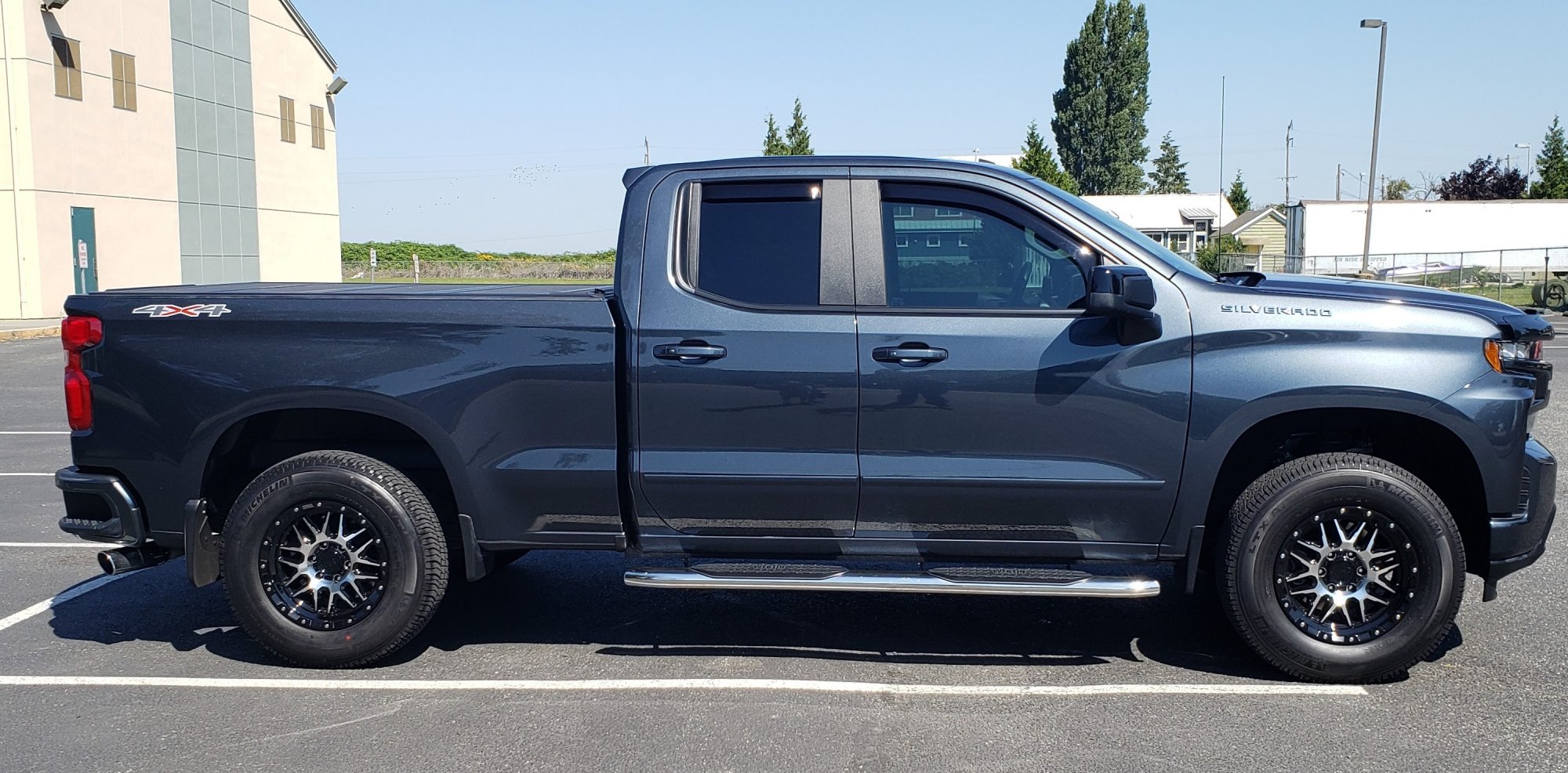

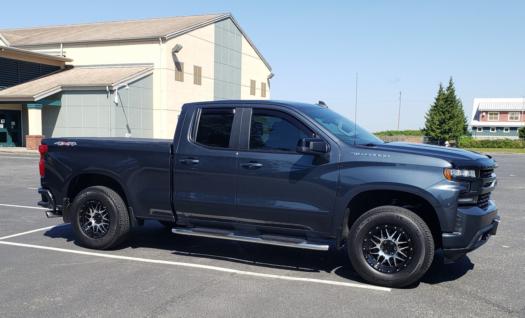

Fuel Rebel 20x10 -18 Offset
No spacers
Nitto Ridge Grappler 295/55/20
Factory Trailboss Suspension
Slight Rub on mudflap on full lock.
Could you show pictures from back or front to see how wide the tires look? Also how much trimming was needed and does it still rub. Looking to get exact setup. Looks amazing

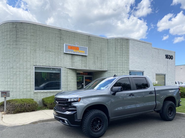

2 Inch Rough Country Level Kit, 18 X 9 Black Rhino Alamo Rims with LTX275/70-18 Michelin AT2 Tires.  I wanted a less aggressive All Terrain tire.
