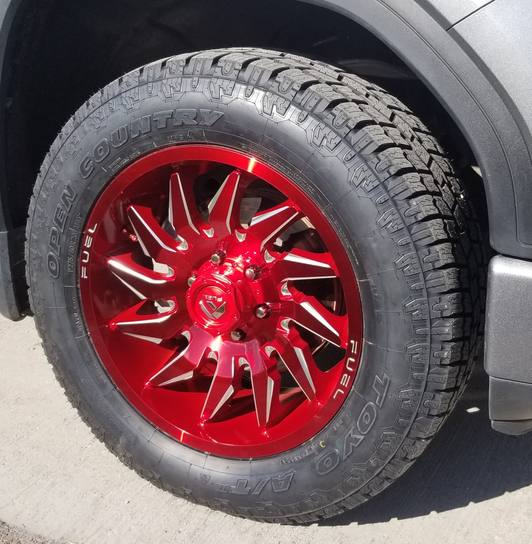

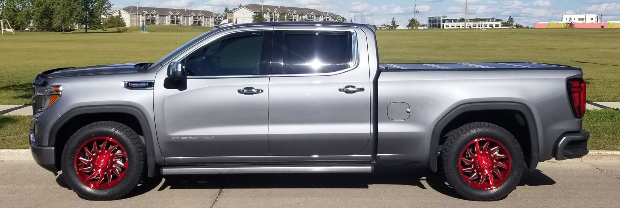

Fuel Saber 20x9 +20 offset with Toyo Ooen country a/t II 275/65/20.
Did you use a spacer? Or did it clear caliper just fine?
They cleared the caliper just fine. 2 -3mm to spare
Niceee. My friend is picking these up for a Chevy 2020 Custom. I appreciate the reply
