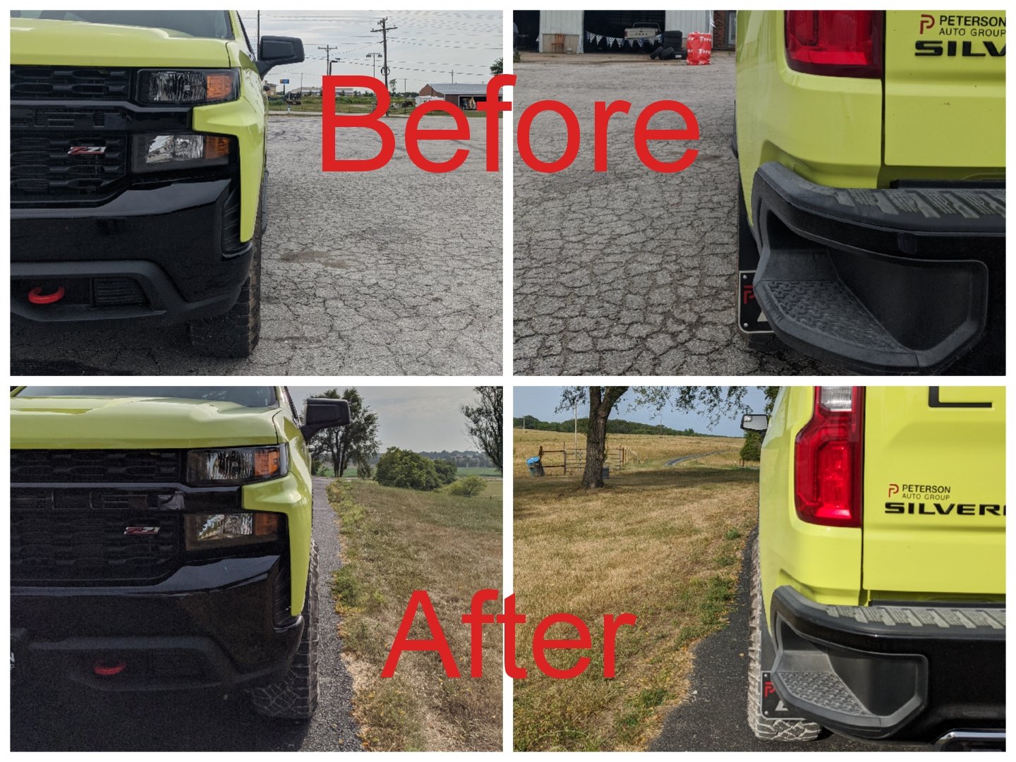

1.75 Bora spacers, stock wheels and tires - before/after photo attached.
2 hours ago, CrunchyBlack_386 said:
Looks great! Any rubbing at all?
No rubbing full lock.  I can fit my hand between tires and front liner and 1/2" clearance on rear liner.
