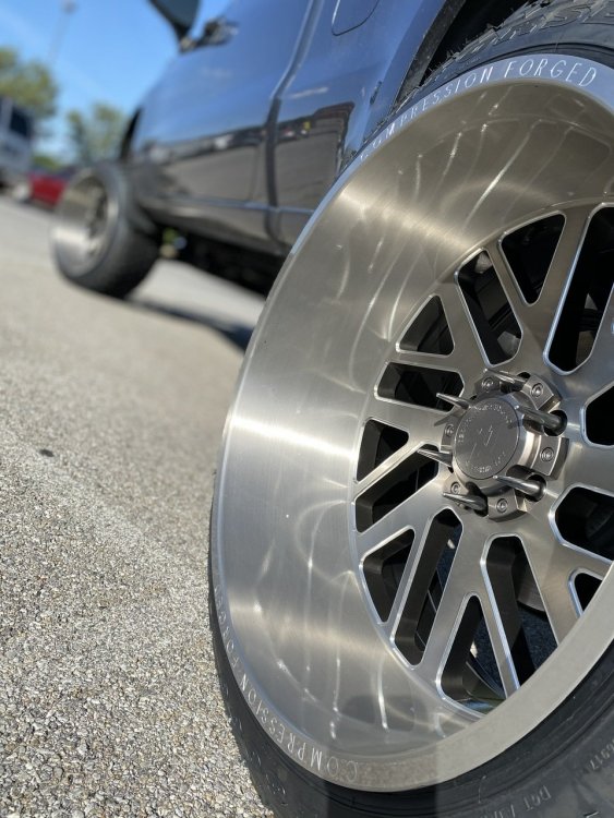

Black Rhino Stadiums 20x9.5 -18 4.5 backspace. Hub centric rings from 78.1-112.1mm
Tire size 295/65/20.
Lift Ready Lift 4” SST

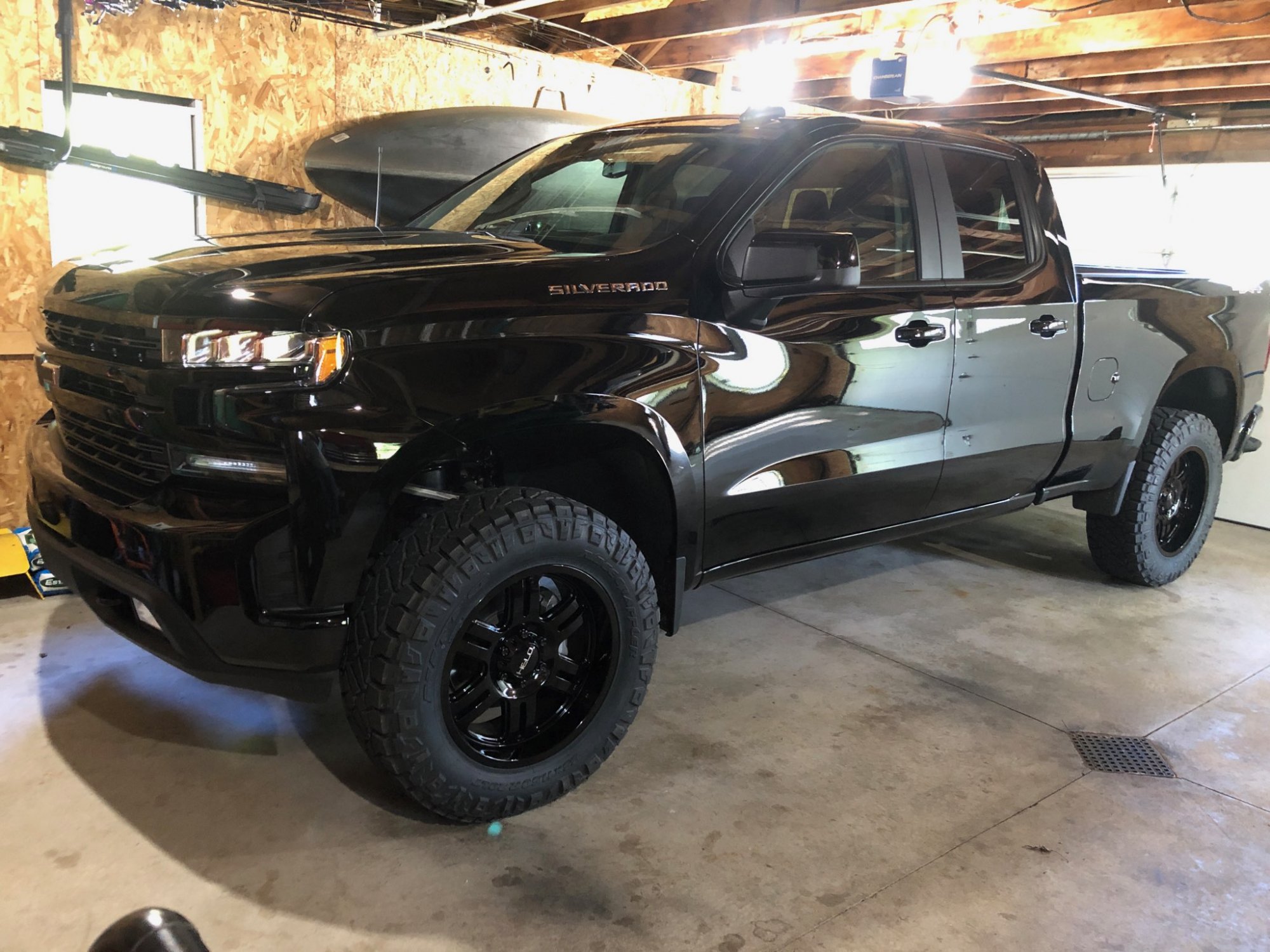

Just got my setup installed this weekend. Running an Ready Lift 2" lower strut leveling kit in the front, and firestone air bags on the back axle (for towing our camper, but also raises the back end up a little at the 5psi minimum). 20x9 Pro Comp Series 40 wheels with -12 offset and 4.5 backspacing. Lots of caliper clearance with no spacers. 275 65 R20 BF Goodrich KO2's. Slight rub at full lock. Had to trim about a 3" square off the top inner corner of the mudflap to eliminate it.
Overall really happy with the way it turned out. I was worried -12 offset would poke more than I wanted because I drive on a lot of gravel, but the tires tuck pretty much into the wheel wells still. I had to order a stubby antenna since the stock antenna drags on my garage door going in and out now.

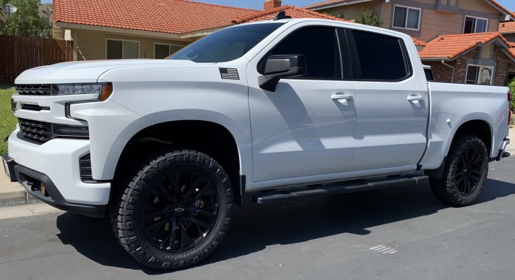

Finally got my setup put together this past weekend. 3.5'' RC lift(struts & blocks) 35x11.5 ridge grapplers on 20x9 Helo 916 +1 offset.
Niceeee. Does it rub?? I just got the same 3.5 RC Kit installed. Did you need spacers to fit that wheel?

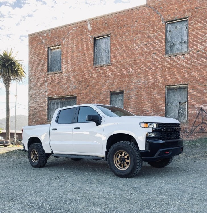

Readylift 8” lift kit
10mm spacers to clear brakes
24x14 Axe Offroad 2.4 -76 offset
35x12.5 Comforser CF3000
Removed lower front bumper valance and rounded off ends of bottom plastic on bumper. No trimming otherwise. No rubbing

It did rub sitting and turning the wheel closer to full lock. I took off the bracket behind the mud flap and ziptied the wheel well liner back and trimmed the mud flap according to where it was rubbing. I have other mud flaps I will be putting on at some point. I do not do any serious offroading so as long as im not rubbing while daily driving im ok with it. Also, I am not running wheel spacers.

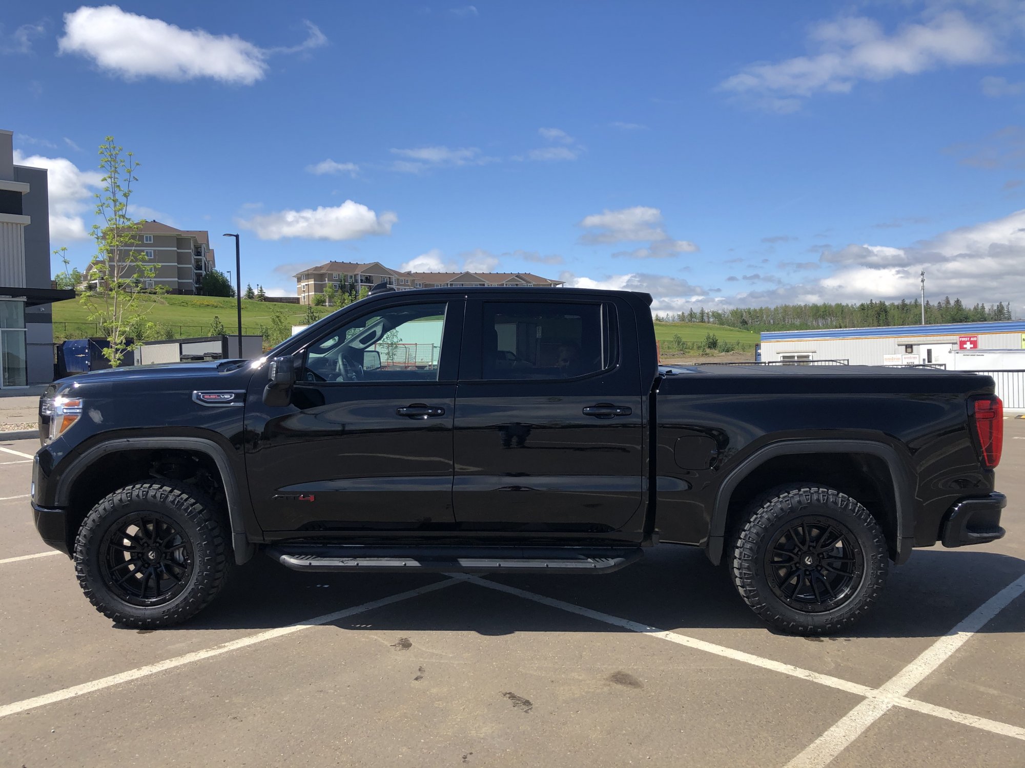

285/55r22 Nitto Ridge Grapplers on OEM 22’s.
Maxtrac 3.5” Lift with 1.5” rear blocks and Fox Shocks in the rear.
