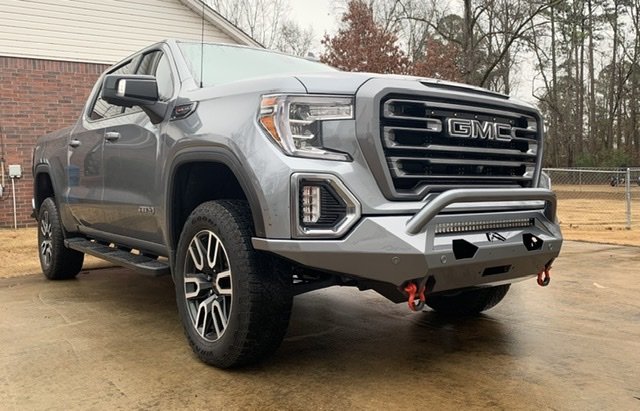

I need some help from the group. I’m ready to pull the trigger on new tires and wheels. I have an AT4 with a 2” Readylift level on it. I would like to go with 35s with 20x10-25. Does anyone have this setup?  I talked to Custom Offsets and they thought they would work if I trimmed the mud flaps. But I would like to hear from the experts here.  Also if someone has this setup where did they rub?  I do have a FabFour bumper so I have extra clearance in the front.

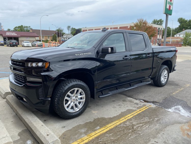

I had Toyo Open Country AT3's installed about an hour ago.  Already much better than the OEM Michelins.  I wanted to keep the stock 18's (budget) and stock 265/65/18 size but wanted more aggressive looking tires that were not too loud, handled better in turns and were good in snow and on dry.  I don't do much off-roading but I had used K02's on my previous Jeeps.  Decided to try something new with the Toyos (they were 10 lbs lighter).  So far I'm impressed (only put about 20 miles on them).  Improved the look and driving dynamics quite a bit.  The ride is a little more firm and less "bouncy" which I like.  Just overall more composed.  If you're in the market, I recommend checking them out.

I'll be glad to share some feedback on some of the builds we've done. Ok so even with the 2" Readlift on top of the factory lift our customers have experienced some decent rubbing when running 35"s with 10" wide wheels and negative offsets. You'll need to trim some plastics (see below) and also from the feedback I've gathered some metal as well. Regretfully we have done one locally they have all been out of state customers so I don't have images of the metal trimming required. I have heard from some customer that with the 20x10 -18 they got away with the below trimming only but I can't confirm that.
Today we're test fitting 35" tires on 20x9 wheels with your exact same lift feel free to email me at admin(@)wheelsasap.com if you like and I'll share my finding with you. After that test fit I'd have a better idea of any challenges you'll be facing.
Trimming guide: https://wheelsasap.com/gmc-at4-oversized-tire-trimming-guide/
