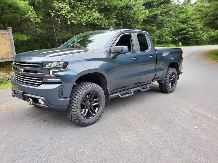

 Got my wheel package installed last week. I’m happy with it. Not bad for a leveled only truck.
Phi Shoe what size/brand tire are these? Really like the look and am looking to replace my anemic 285 45 22's.

They are Fury Country Hunter RT’s (Hybrid Tire).
these 33x12.5x22. The pictures don’t even do them justice. Pretty much everyone that’s seen them seemed to like them a lot. They are E Load so a little rough but no more than my E load TOYO’s were

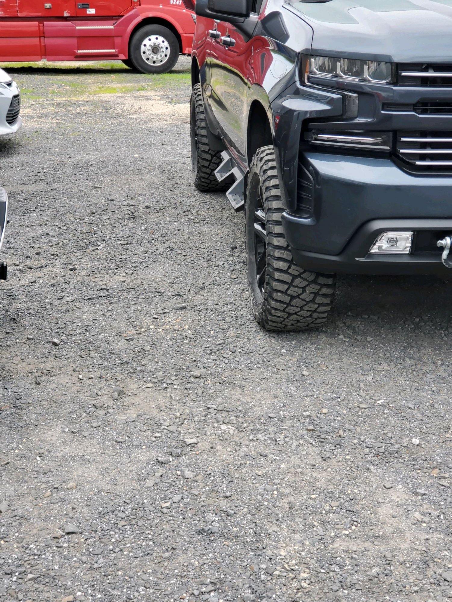

Phi Shoe - Are those 22x10 -19 wheels? Any rubbing with that setup? Any chance you have a pic from the fender angle to see how much they stick out past the fender well? Also I assume no spacers, right? Looks good!
Sorry meant -18 offset...

Yes they are 22x10 wheels. They rubbed in reverse at full lock I trimmed mud flap and seems to have corrected most of the issue. No spacers. Here’s the best picture I have from fender. I would say inch and half to 2 inches of poke.

Awesome, thx. Has a nice look and stance to it. Am I right that your rig was standard suspension (not Trail Boss) before leveling it? Just a front level kit? Sorry for all the q’s, appreciate the response.

Yes it’s a z71 no trail boss
