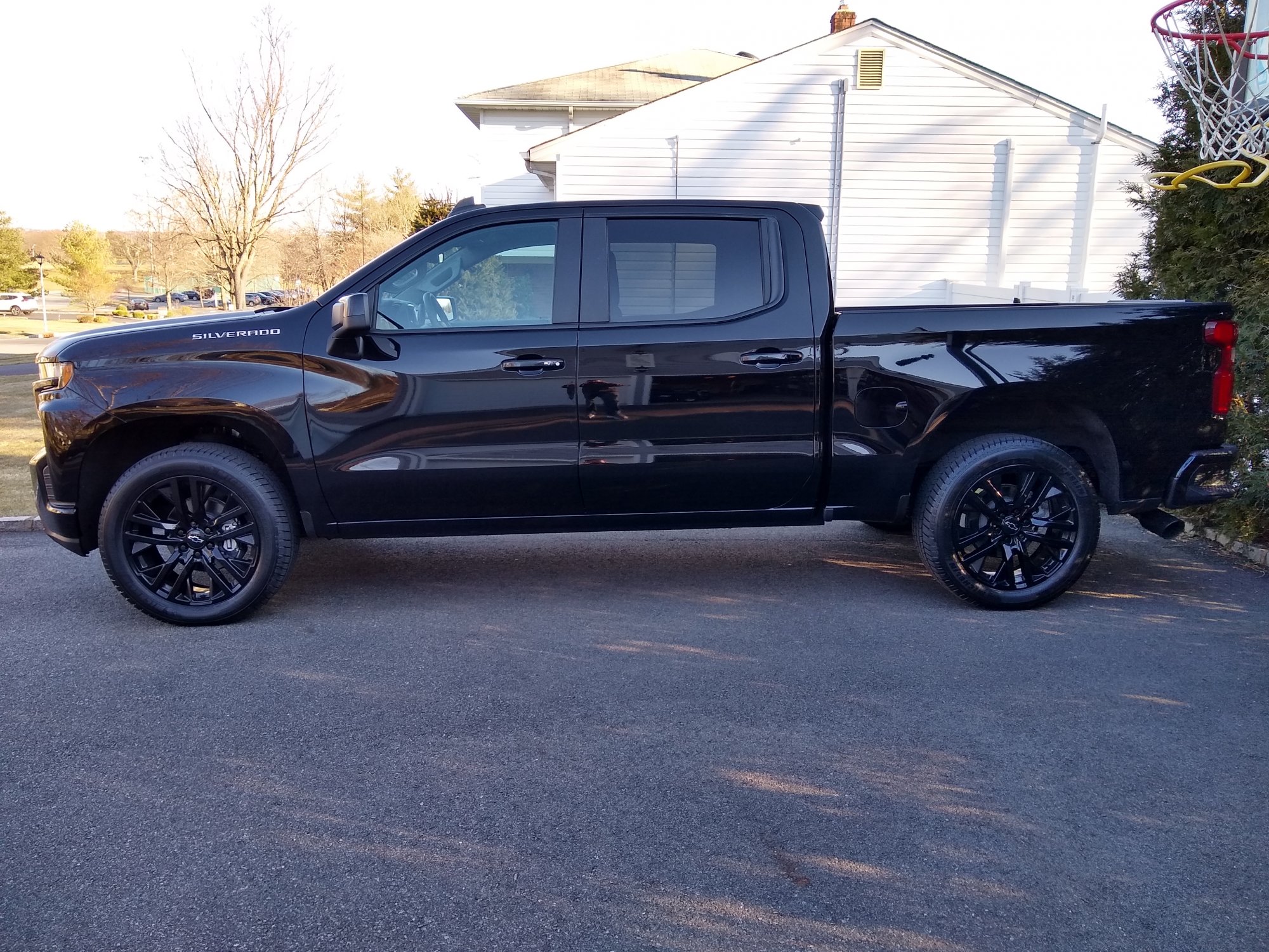

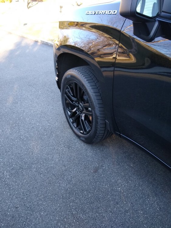

I agree how great these tires are. I've had these on all my trucks and SUV's. Once I saw they were offering them in the oem size for this truck it was a no brainer. The ride, traction, and handling is leaps and bounds ahead the Bridgestones it came with. They look great too. Really compliment the truck. "Made in the USA" stamp on the sidewall is nice addition.
BTW, the 275/50R22 is a new size for the Michelin Defended LTX M/S. Michelin has offered it in 285/45R22 for some time, but the 275 is new. It is a 33" OD tire.

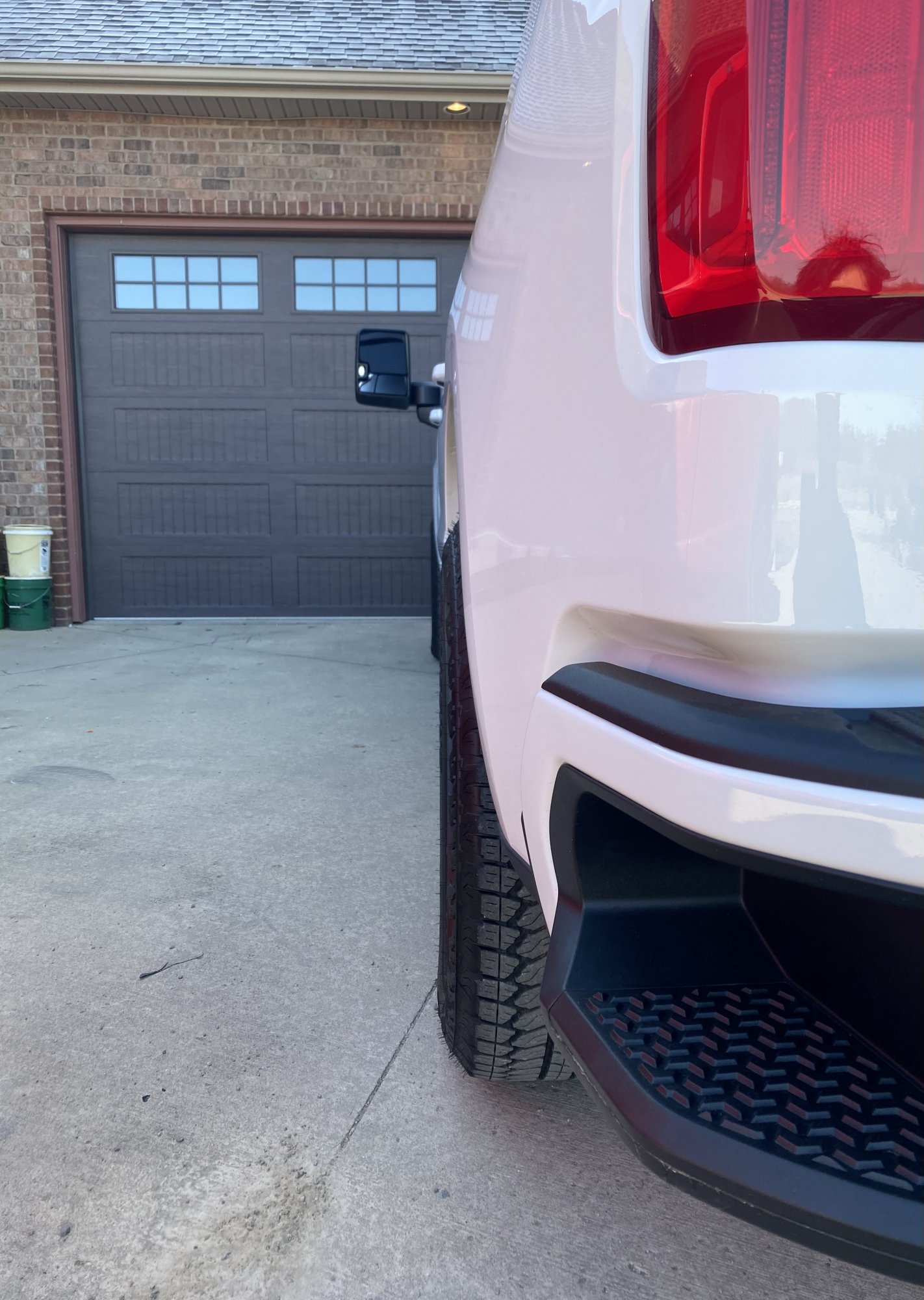

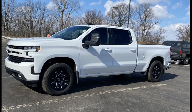

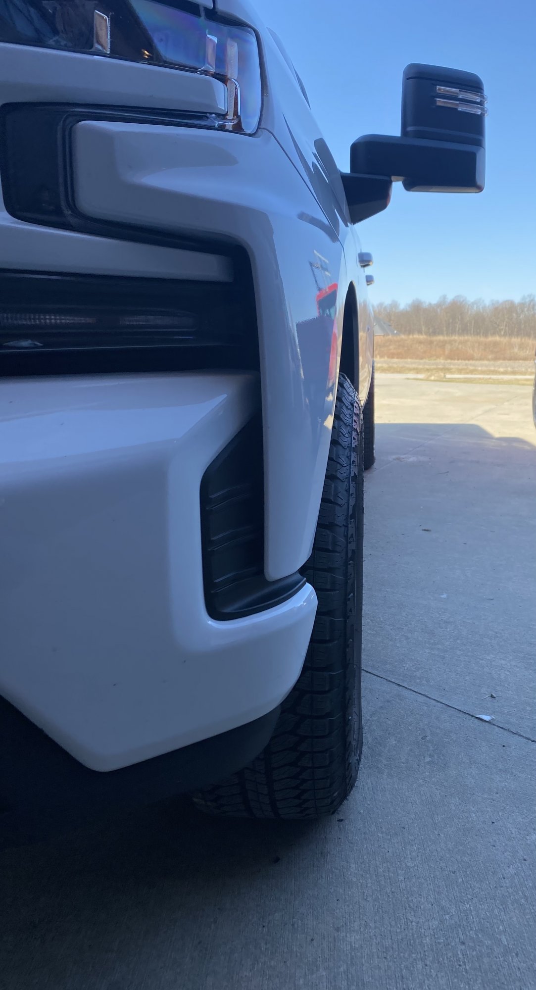

9 hours ago, JCattSS said:
Fuel Hammer 20x9 +01 stock Bridgestone 275/60
finally someone with the offset im looking at. I have a few questions, Are you lifted or leveled and, did you half to do any trimming to get the +1mm offset to clear with stock tire sizes?  Or are you stock height and just put the wheels on with no trimming or fitment issues?
Also can i get a pic from down the side to see how much poke you get out of +1 offset? It looks like you get quite a bit especially if you dont half to do any trimming
Thanks bud
Edited by puppykat33
Hi
Truck is stock height. Just used the stock tires since they only had 400 miles on them. It did rub slightly at full turn in reverse so I removed the bracket behind the mud flaps, didn’t trim anything. The offset is nice sits just a little aggressive.
9 minutes ago, JCattSS said:
Hi
Thanks Bud
