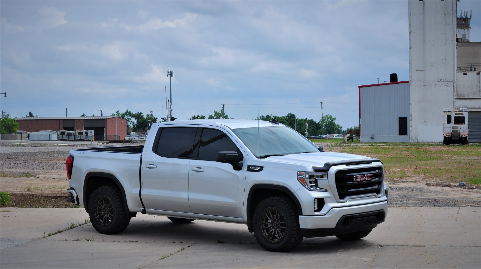

I installed these awhile ago but this is my 5.3 Elevation. It is levelled (in the rear). 20x9 Fuel Rebels on 33" Kendas.

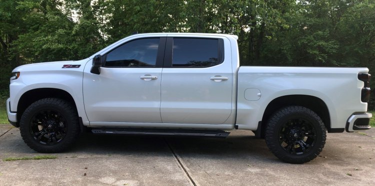

Here is my setup
Fuel Vapor 20x10 -19mm offset
Nitto Ridge Grapplers in 275/65/20
I put on ready-lift 2inch leveling kit
did a mudflap bracket delete with trimming the innermost portion of the flap and zip tied the liner in one spot.
No rub at all
Used this forum to pick out my specific wheel and tire set up so I’m returning the favor!

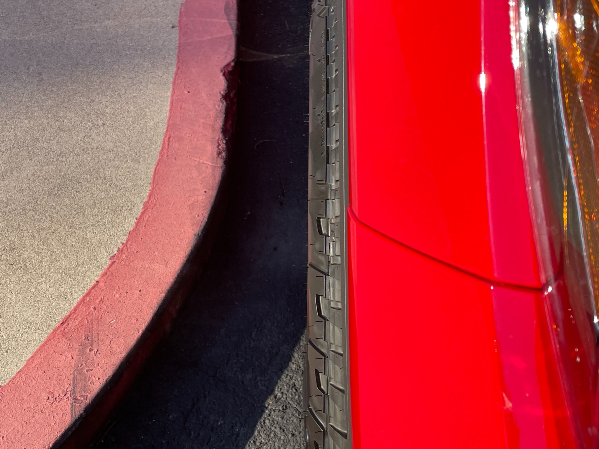

Looks great! Do you happen to have a photo down the side showing how much poke there is?
I do. It should be somewhere around 1” of poke over factory. Also added a picture of the clearance at full lock. I wasn’t interested in going any bigger than the stock tire sizing because I didn’t want to impact fuel economy too much with weight, overall I believe the new setup is just a touch lighter.

Thanks, that looks good. I actually had ordered these wheels a few days ago but in a +15 offset and 9.5” wide. Didn’t realize they had the other offset and widths available.

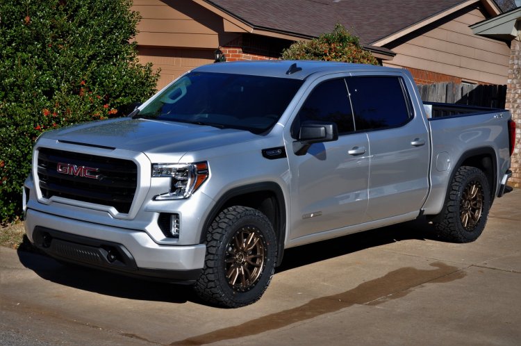

Here is mine.
2020 Silverado LTZ Z71 4WD
Bilstein 6112's in front, 2" level
Bilstein 5160's rear with 1" block
Fuel Sledge 20x9, +19mm, ceramic coated
Toyo A/T III, 285/60/20
No rub. Tires stick out past fender by about 5/8". Very happy how it came out.
