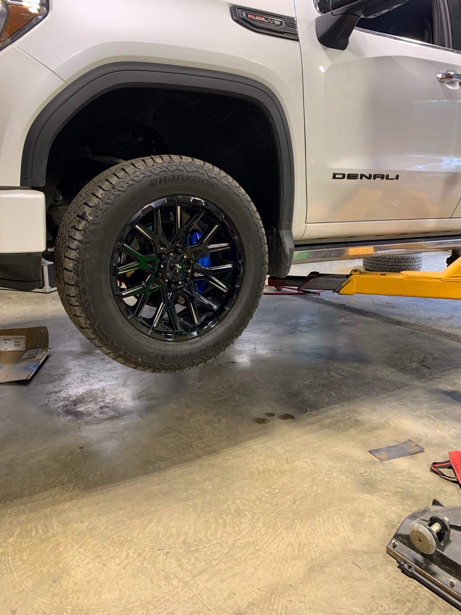

V-Rock Recoil 20x9.5  +15
Hankook Dynapro At2 275/60/20
1.5” spacers had to grind down calipers some

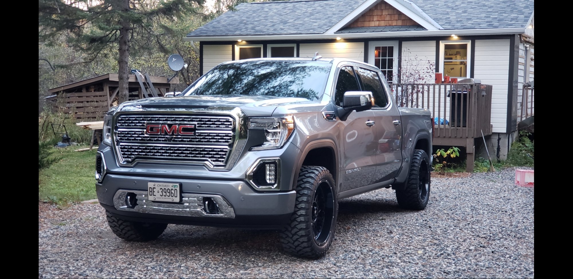

On 10/14/2020 at 5:13 PM, Freddotron said:
2020 denali
2 inch level
22x10 -19
33 12.5 22
No rub
I know this is late but I’m going to be running this exact same set up on my 2021 Denali. Same vision wheels same size tires with 2 inch level. Everything is in the mail.
I’ve been racking my brain doing research. What kind of trimming did you have to do to get it to no rub? Thanks! Great looking truck btw!

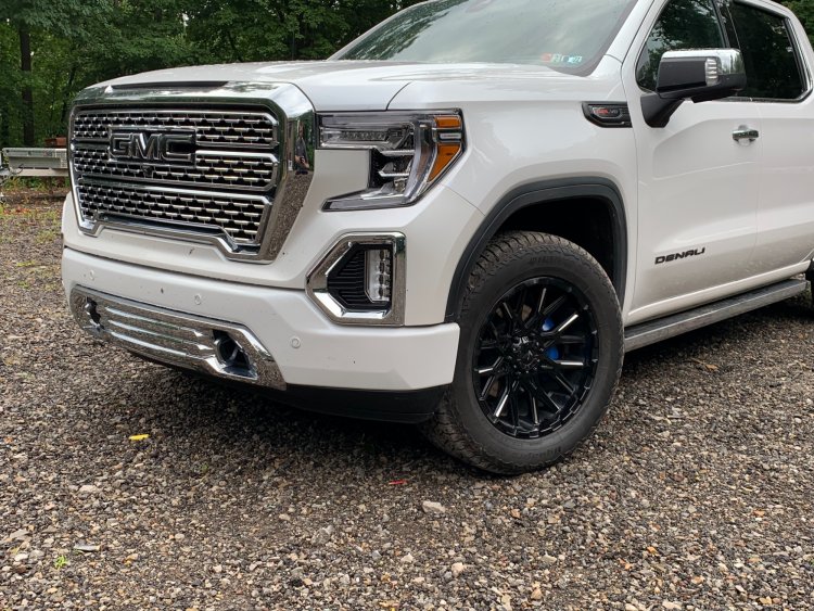

On 6/20/2021 at 3:53 PM, PureZ71 said:
Replaced my stock 18's with 2' spacers for a set of Fuel Block D751 (18X9, -12 offset). I believe this offset is just the perfect amount for these trucks.
http://www.fueloffroad.com/wheel/14570/fuel-1-piece-wheels-block-d751/?finishID=4434&lugs=6
I'm gonna be running the same setup soon. What hub rings did you use?
Nice nice... just the ones that came with the wheels
Edit: updated photo
Edited by PureZ71
