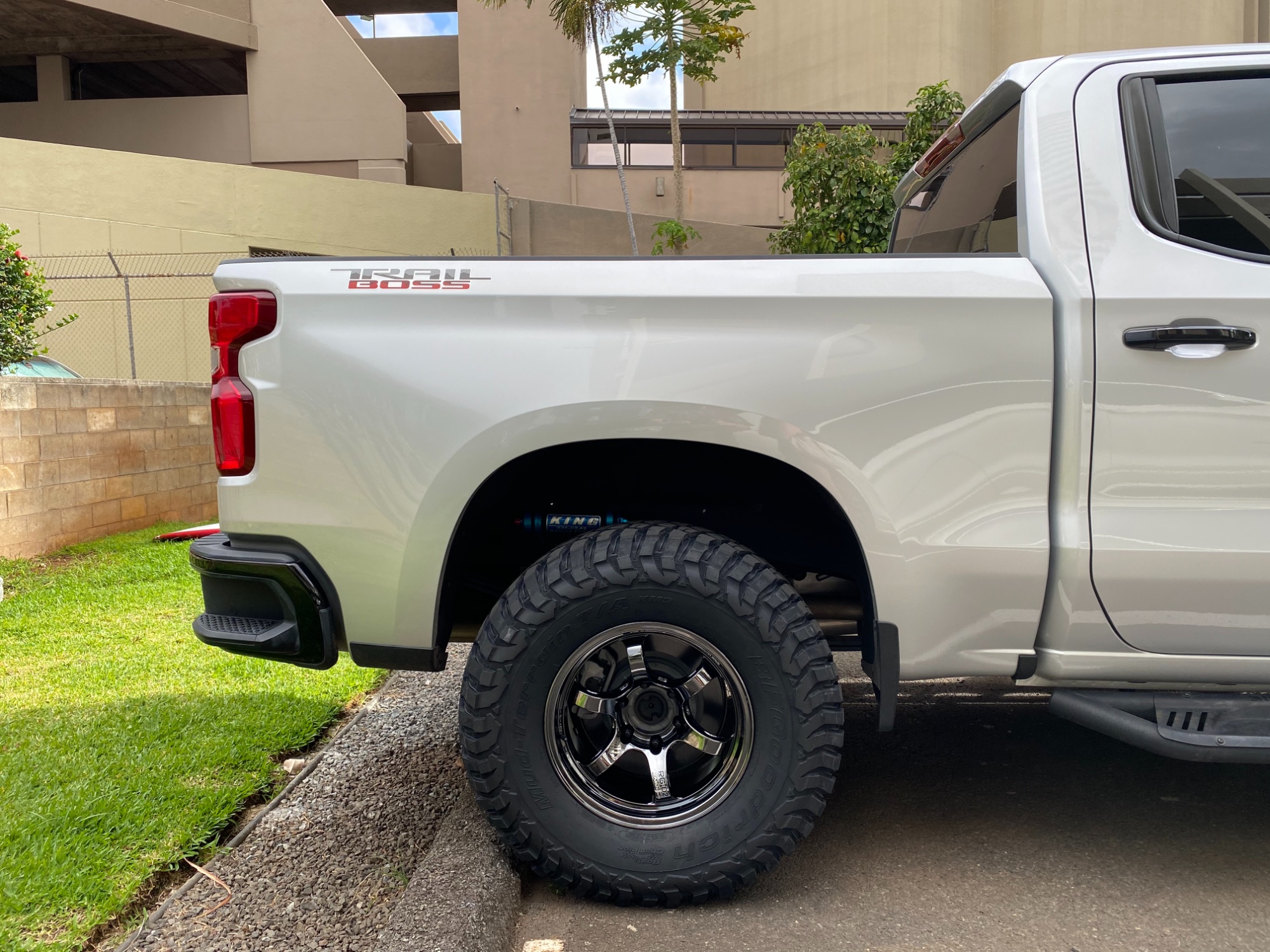

On 5/28/2021 at 7:20 PM, f0urtw3nty said:
advan rgd2 17x8.5 -10
35x12.50x17 km3
trail boss w/kings
Got any full body pictures of your truck?

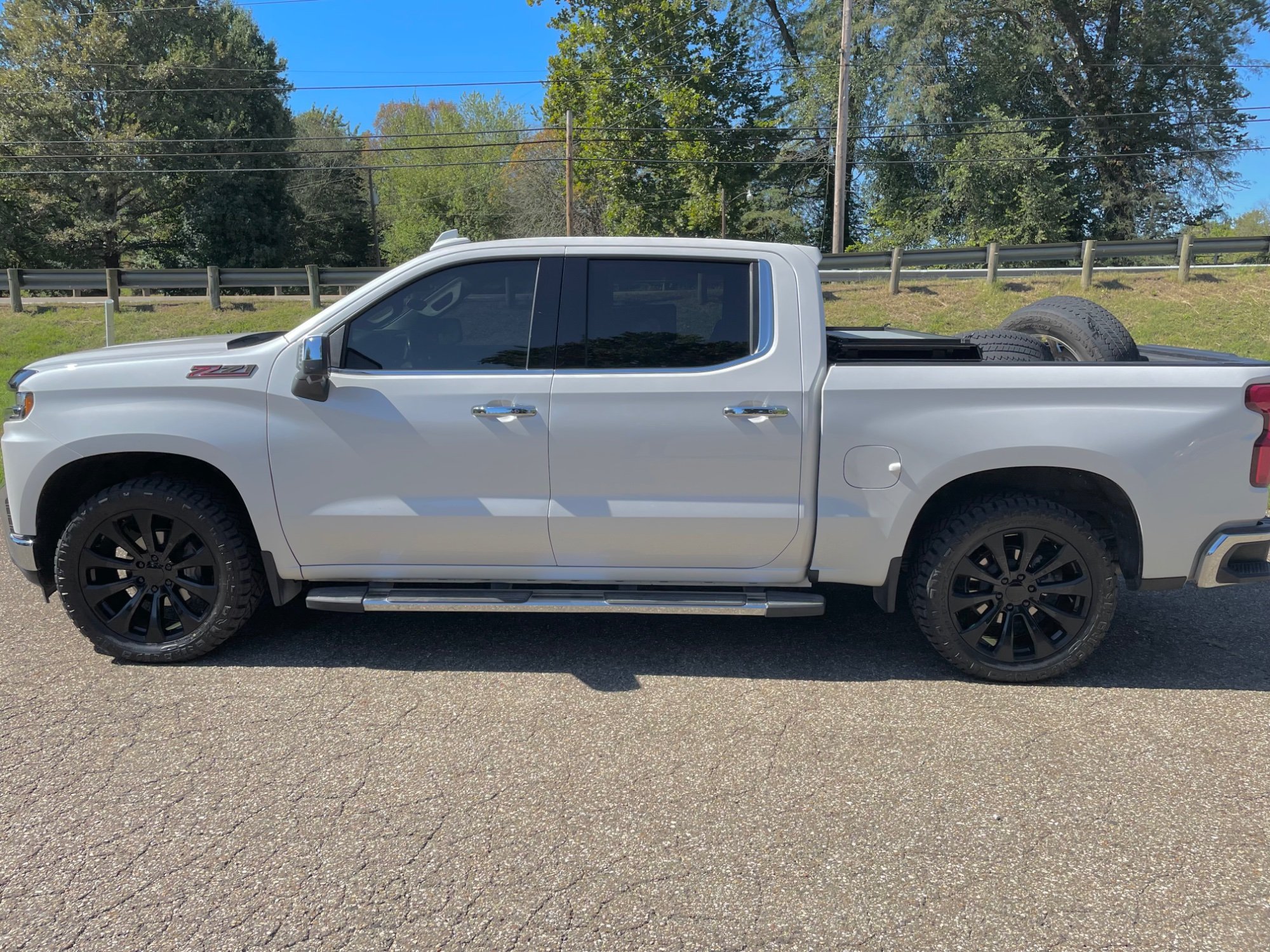

18" Black Rhino Mozambique wheels/ Falken Wild Peak AT3 275-65-18 tires, 2" ReadyLift levelling kit.  Drives great, still gets 25+ combined mpg, and it dropped 11lbs per wheel/ tire compared to the stock 22's.  Overall diameter is down slightly compared to stock, but exactly the same as the AT4 18" setup.

With the 2" ready lift, did you check your before and after measurements? I've read many other said they really only got about 1.5" out of the spacers.
Wow, that looks awesome, makes me want 35's and that bumper on mine.

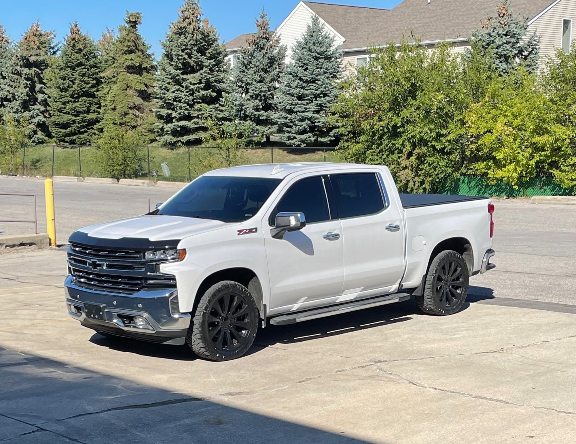

Going against how I have been for MANY years I made a subtle swap this time...went from the stock 275/65-18's on my TrailBoss to a 275/70-18 Ridge Grappler. I wanted to keep my power, good ride, and performance. I have scowered the board looking for pics of another and couldn't find any. Overall I am pleased. I had 295/70-18's on my previous Titan XD and I know they would have fit here, but I didn't want a stuffed look. Also didn't want to level it and have to change the UCA's so here it is:
 I've been looking for this exact tire set up with stock / nearly stock suspension set up.  Thanks!

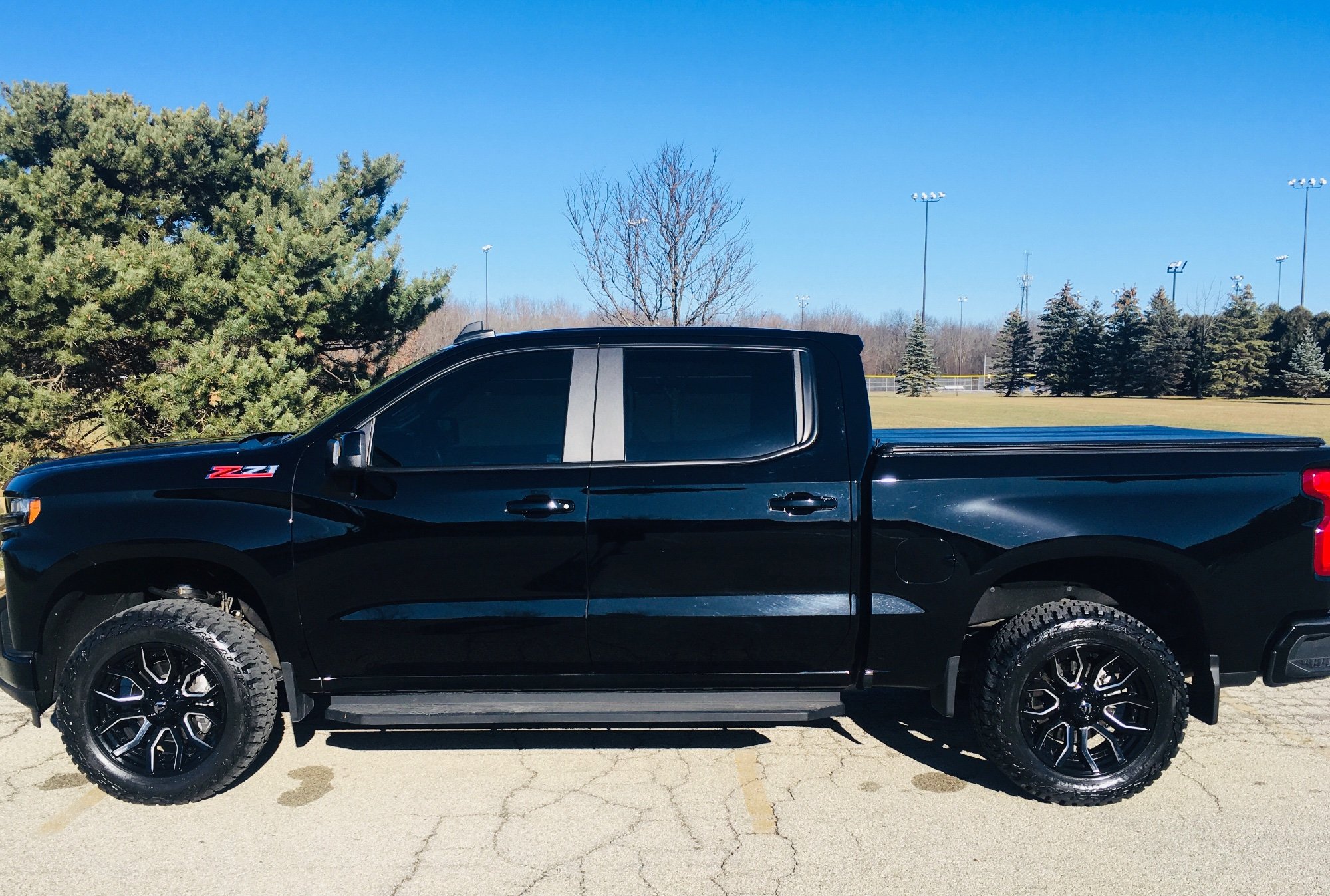

2020 RST Z71
20X9 +1 Fuel Rage black&milled wrapped in AE07D955-6F6A-4607-A966-AEB26568AFEF.thumb.jpeg.abdddf06fdc59a0d43d980b6bd83d6d3.jpeg33”x12.50” Mickey Thompson Baja Boss A/T’s. I have a 3” Superlift suspension lift and the Borla exhaust with the black chrome quad tips.
