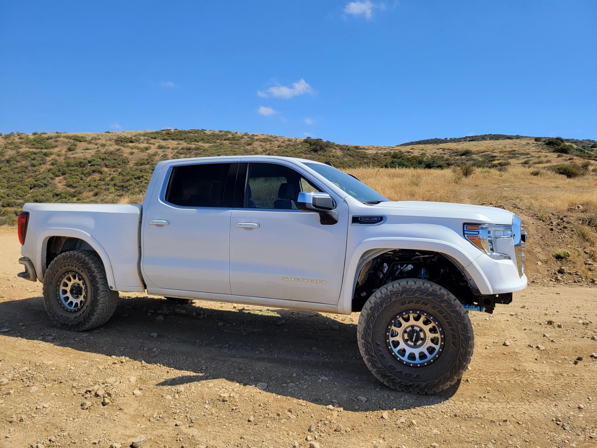

On 12/2/2021 at 1:14 PM, Peter S said:
17x8.5 Method 305 with 0 offset
37x12.5 Toyo RT
Dirt King long travel kit and fiberwerx fenders+bedsides
No rubbing after minor fiberglass trimming near the firewall
Sweet setup!!!  I want to go with 37's so bad- but I drive too much!
