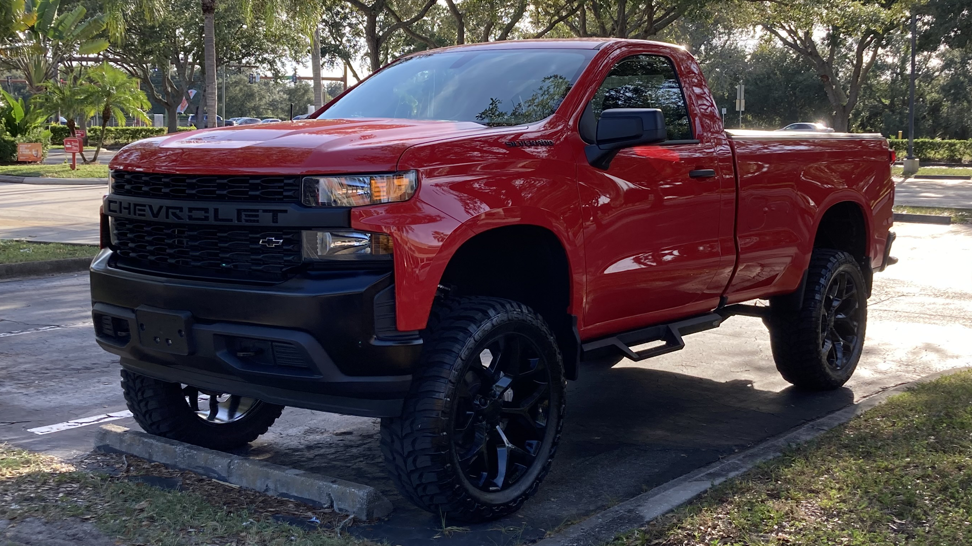

2020 Silverado 1500 5.3 WT 4x4
Snowflake 24X10 +27
Crosswind M/T Mud 37X13.5X24
8 inch ReadyLIFT
No spacers
No rubbing
No trimming
Edited by Lycan LLC

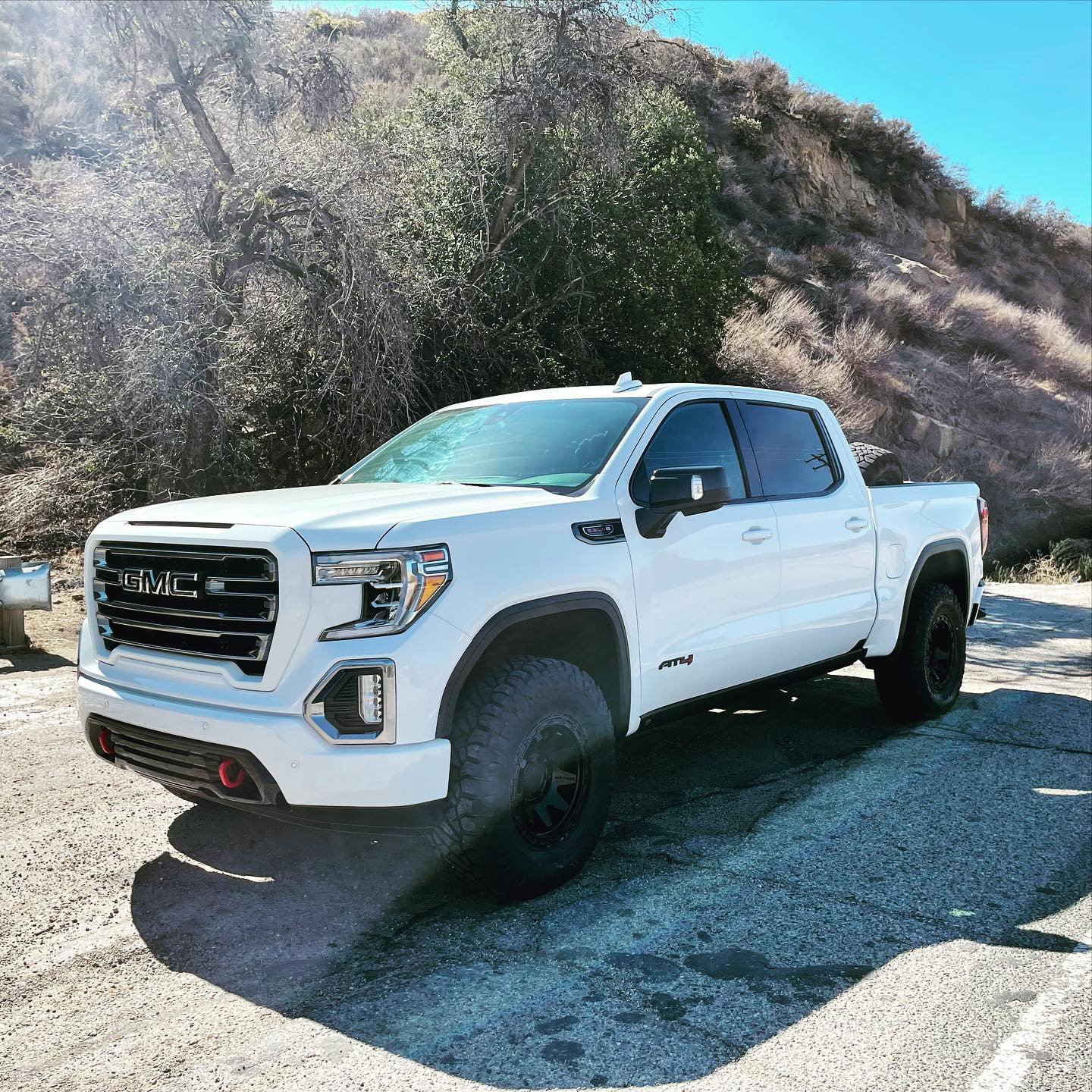

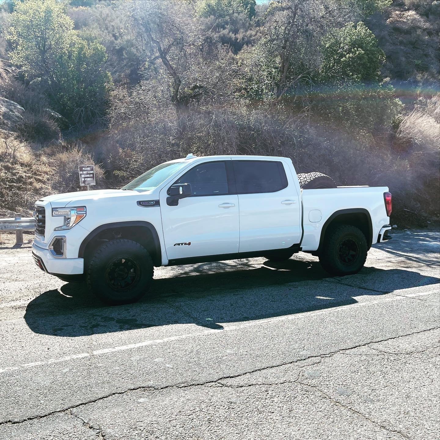

Looking to replace the stock rims and tires on my 2020 GMC AT4.  Looks like a lot of people are running 18X9 with -12" offset on 35X12.5X18.  Does this sound correct and will it rub with the stock suspension?
Thanks
Colton
Edited by cjkiefer
Thanks
Colton
It'll possibly rub slightly towards the firewall at full lock. Removing the bracket behind the mudflap will clear up some more space. Pretty much guaranteed to rub while at full bump and turning. If you stay mostly on the streets it won't be much of an issue though.
