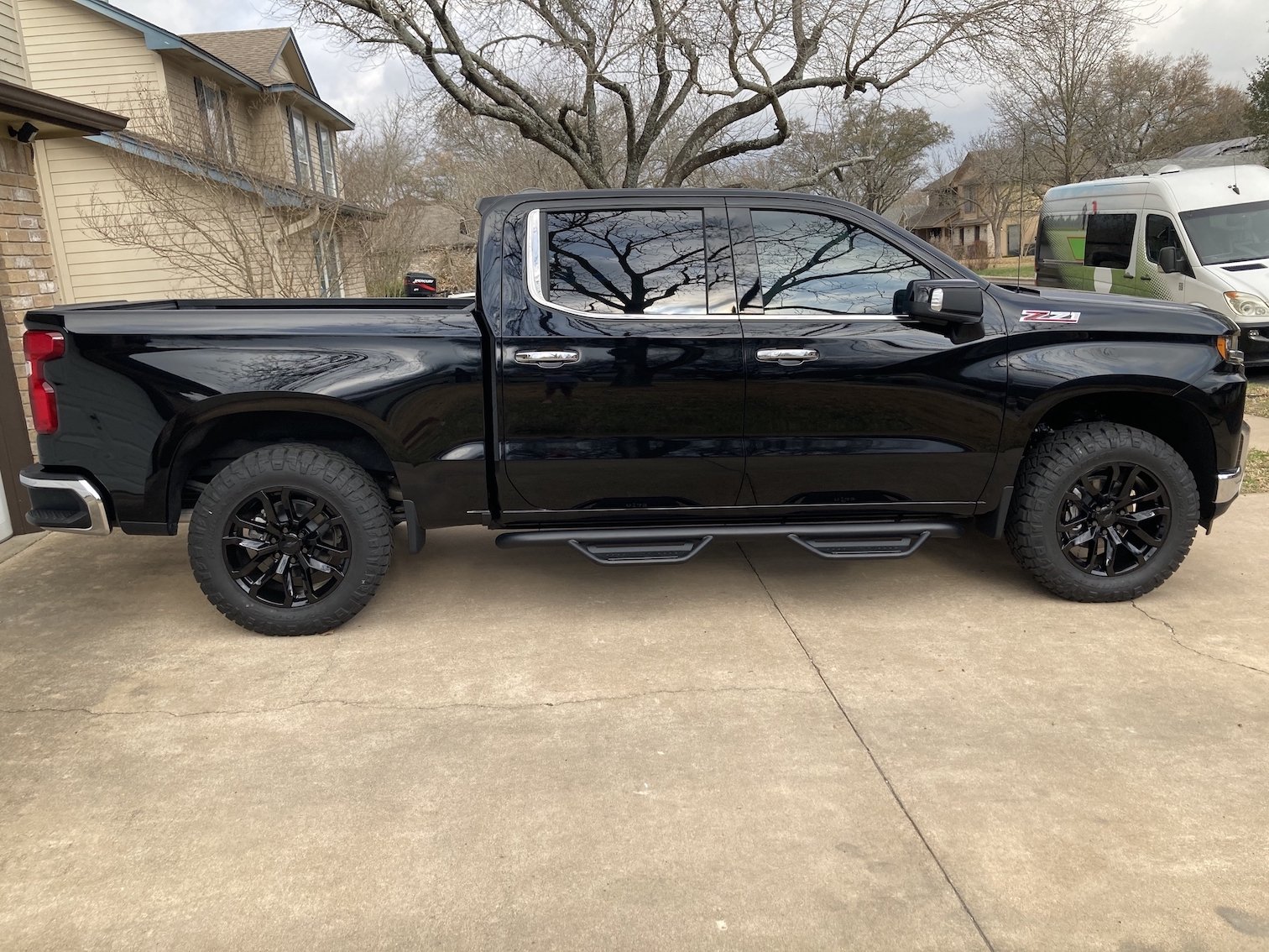

Figured I'd post on here as well.
- Ready Lift 2" SST Lift
- Stock 18"s rims
- Toyo Open County R/T 35x12.5R18
- Supreme 2" spacers (You can get away with 1" if you want. The reason I got spacers was to clear the aftermarket upper control arm)
- Mud Flap Trim delete kit
- Removed the metal bracket behind the front wheels
- Trimmed the liner behind the front wheels so it doesn't rub anymore

First off, truck looks fantastic, bravo very clean yet OEM+ look.
When you mentioned mud flap kit, did you purchase a separate kit to replace where the oem flap is? If so can you link that for me?

Of course. I only used the front part of this kit.
https://switchsuspension.com/chevrolet-silverado-1500-2019-2021-front-rear-mud-flap-delete-kit/
