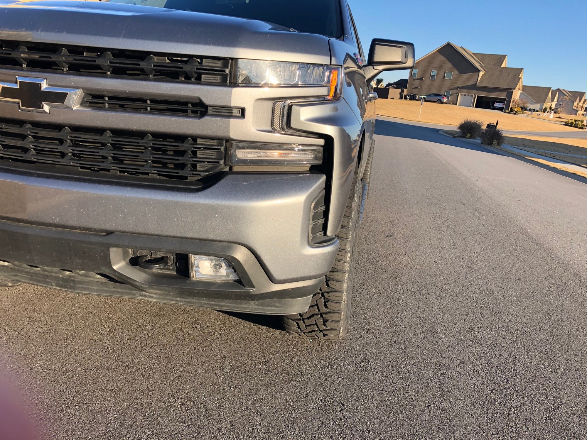

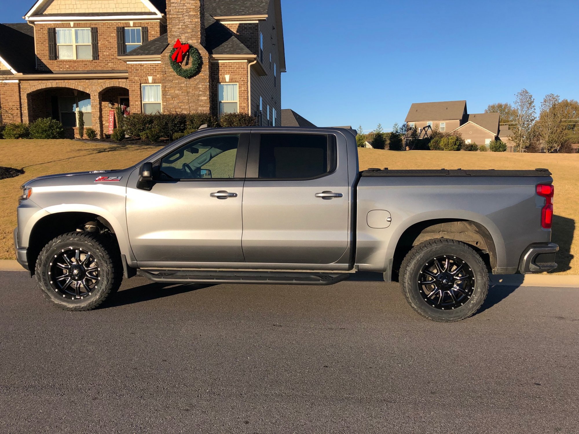

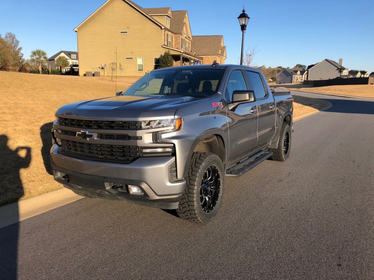

2020 RST
3.5" Rough Country Lift Kit (lift only - not leveled)
Fuel Vandal Wheels 20 x 9 x +1 offset (I think)
Toyo Open Country A/T  305/55/20
Little trimming on the inner side of the mud flaps
Rubs just a touch when turning in reverse
I basically copied one of the members here.  I like it!

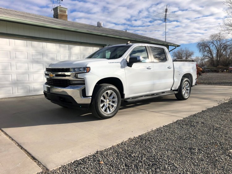

285/65R20 (34.6x11.5) Cooper Discoverer AT3 XLT, 2019 Sierra SLT 6.2, OEM SLT Wheels, 2 inch front level, 1 inch rear block. No rub in drive. Rub at half lock in reverse. (Anyone know why these trucks rub only in reverse?) I'll be removing the mudflap bracket and zip tying the liner back to alleviate that rub.

Tires rub in reverse due to the rubber bushings letting the suspension shift forward just enough, and the front end can dip down just a bit as well.

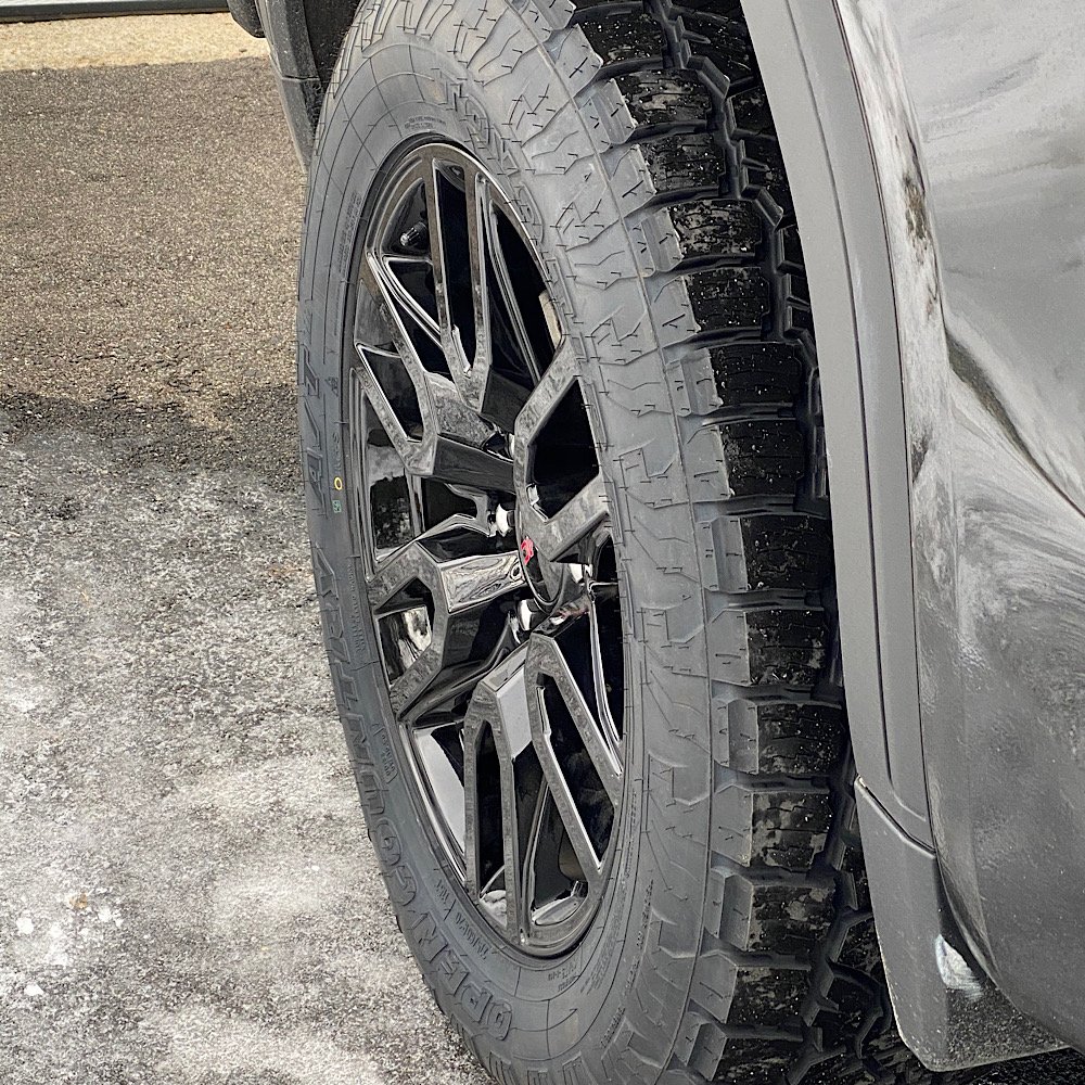

Traded in the stock Bridgestones shoes for the Nitto terra grapplers. 285/45 r22 week ago Friday. Took them for a fresh snow drive today and they worked great.
