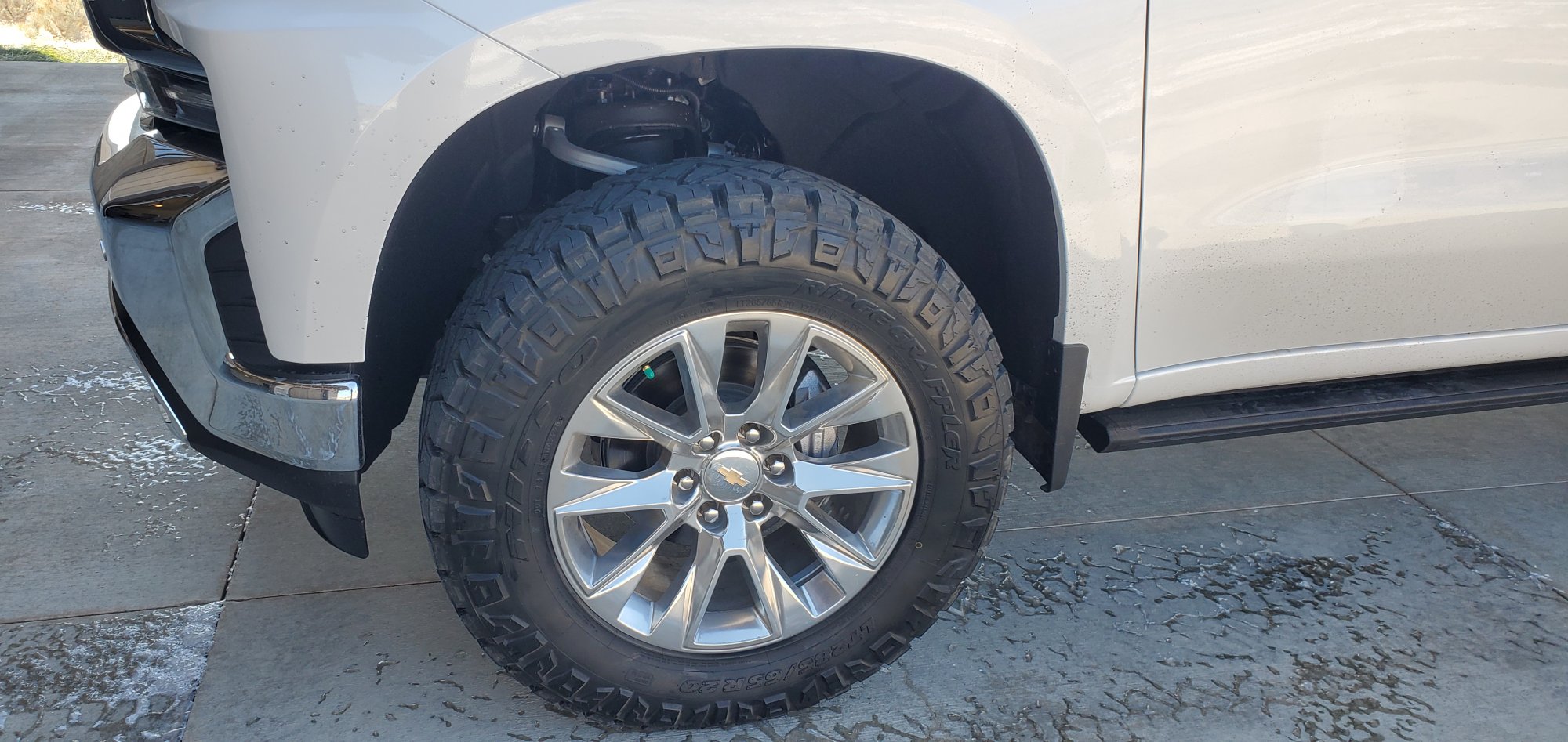

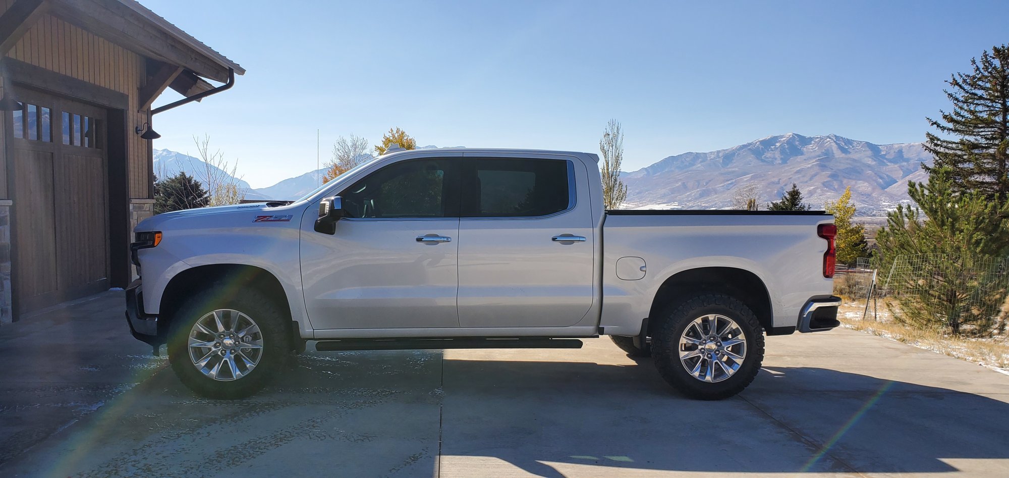

2020 Silverado 1500 LTZ ~ Z71 w/ 3.0 Duramax
Nitto Ridge Grappler 285/65R20 127 Q Tire
Stock 20" LTZ Wheels
Rough Country 3.5" Suspension Lift Kit w/ Lifted Struts and V2 Monotube Shocks
ReadyLift 15-3485 1/2" Hub Centric Wheel Spacer (front only to prevent rub on control arms)
Notes:
  • Tire PSI set to 45 as per Nitto recommendation.
  • Rough Country lift is not level.  Measurement from ground to top of fender well is 40.75" in the front and 41.75" in the rear.
  • No rubbing.

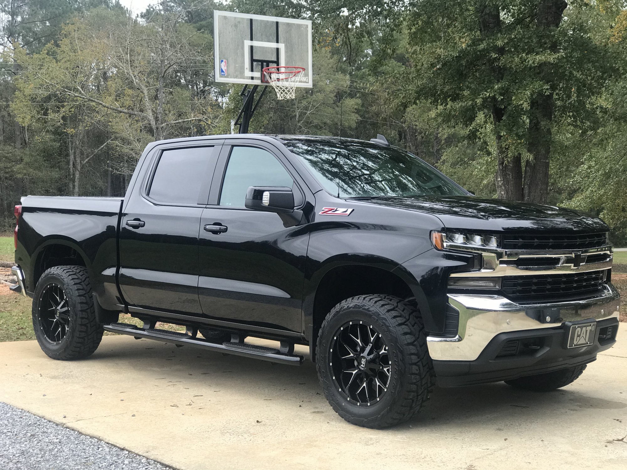

Fuel Vapor 20x10
Nitto Ridge Grappler 35x12.5
4” Zone suspension lift on top of factory TB 2” for a total of 6”
minor trimming of the wheel well
That is the exact setup I am looking for. How do you like that lift so far? Looks great!
